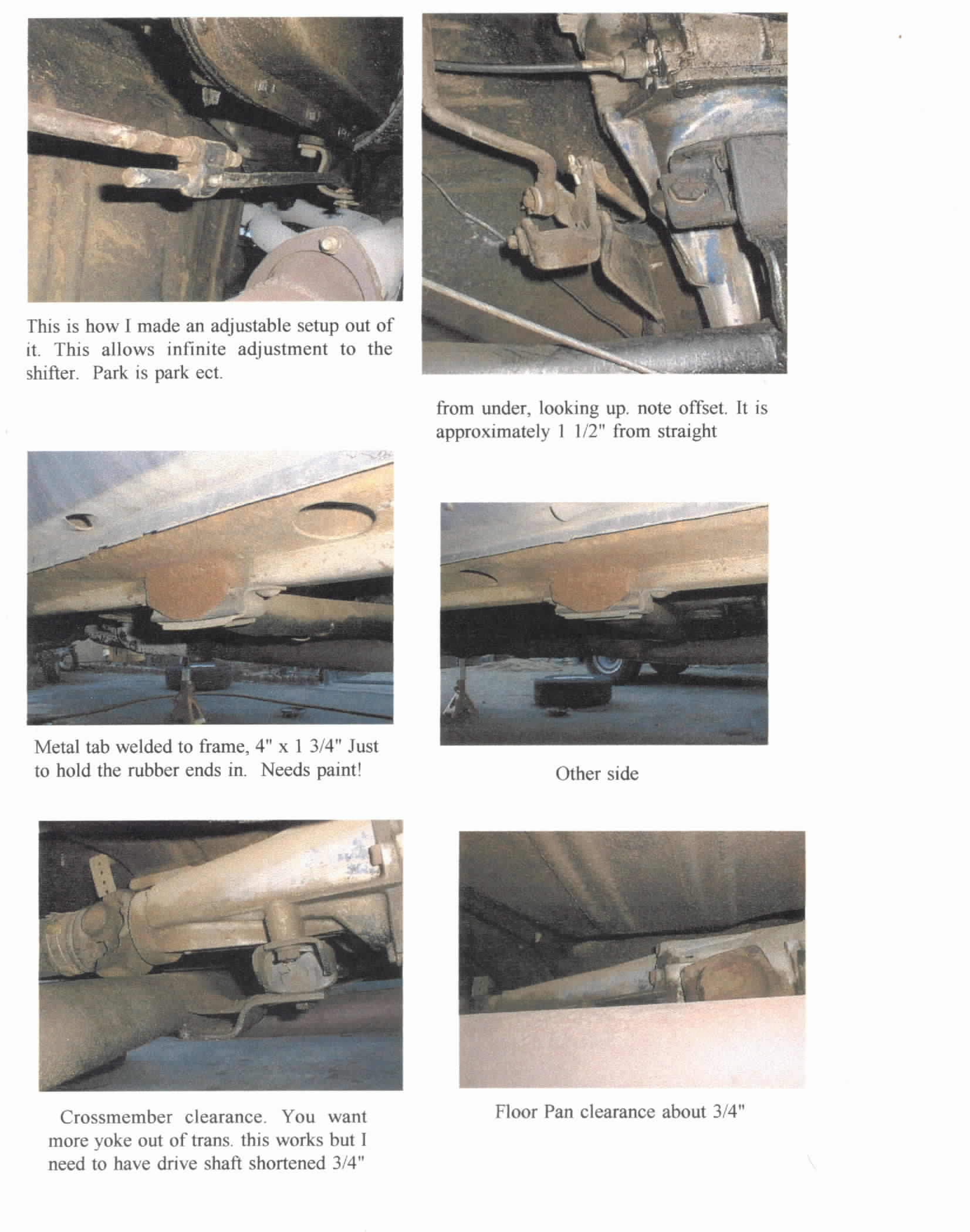

I hope these pictures help many of you who are trying to rid yourself of a slim Jim...

Sorry about the size of the pictures but I'm sure you won't need a magnifier to get the Idea of what I did. Only problem is that I have to still shorten the drive line about 3/4's of an inch but the car drive's wonderful....

here is the last set of pictures, and for all of you guys that are thinking of doing this. Do it and you won't be sorry, just remember that the 63 engines will not have bolt holes for the starter so if you can find a newer 389, or go with something else as I did (455) You will have a blast once you drive it!!

Thanks for the info! Did you use a shorttail on the wagon? It is a shorter wheelB than sedans.
Also, you can use a crossmember from a pre- '75 Caprice that is flipped & bolted to the bottom of the frame to allow for duals & speedo cable clearance. It has 2 humps that are perfect for this & allows for regular mount - for those of us w/o a welder.

I've also seen the flat 65-66 full size crossmembers used, as they have kickups for the exhaust, and are wider.

I have used the cross member from late 70s and early 80s B and C body cars as well. You have to look hard to find one out of a Buick, Olds or Caddy diesel that will have the double hump for dual exhaust.
