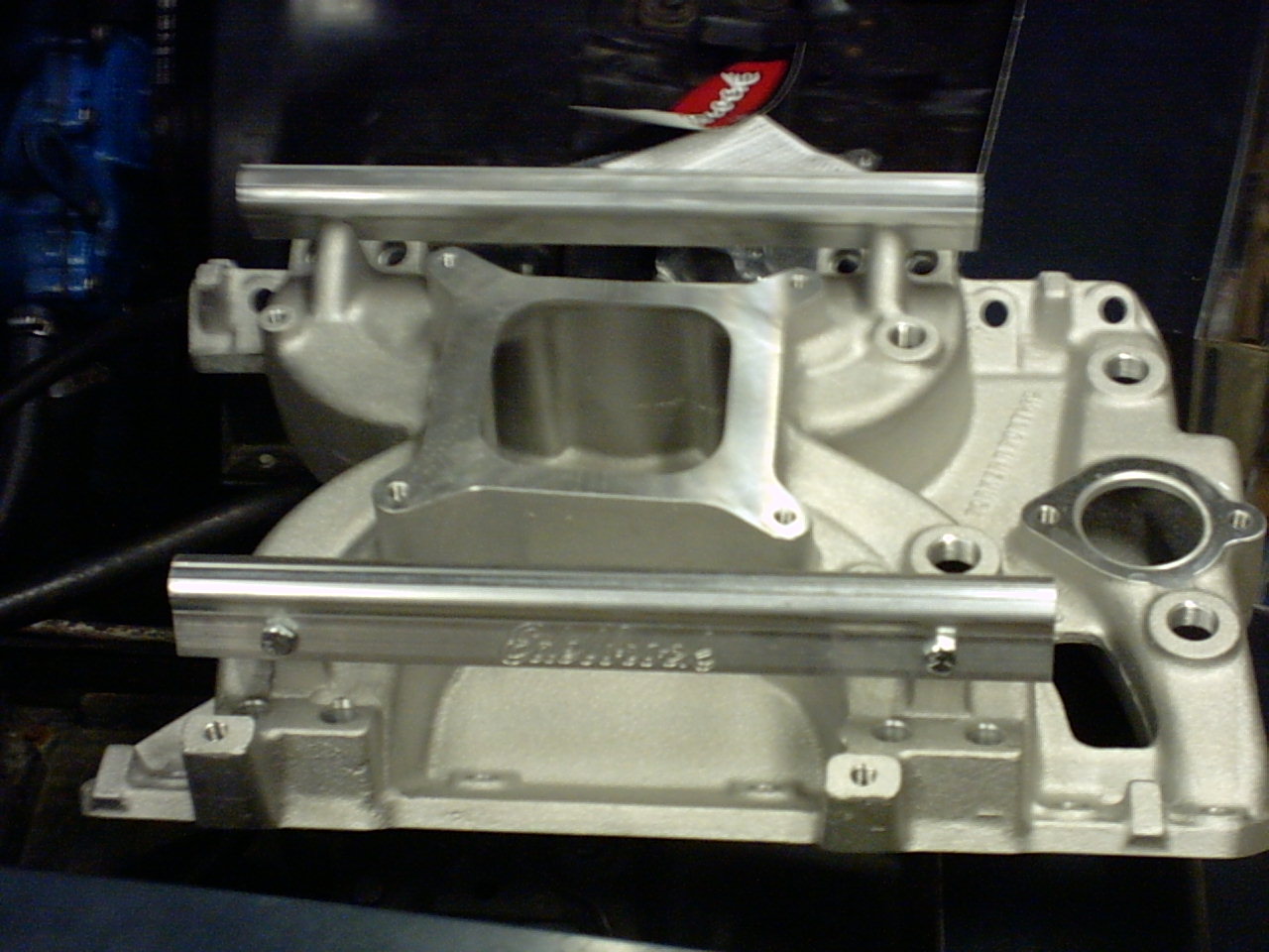

I finally got one of those Edelbrock intakesand a set of fuel rails that I've seen on their website.Now I've got to sta the yard sales up to get the rest of the parts (hehe). This intake is based on the torker II part # 50565an the fuel rails are #3637. They have two other intakes to choose from.

GOOD GOD! That picture is huge. Sorry guys. lmao

I'll be picking mine up this Sunday from Summit. What's the front-to-back offset between the left and right fuel rails? I'm trying to finalize the design of my fuel system.

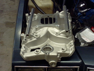

Not sure what you mean there but. Here is another picture but smaller.LMAO

I finally figured how to resize the pics lmao. So here is the first picture resized.

How high are the fuel rails compared to carb/TB base?

I looked clser and no exhaust crossover??

Does this new setup come with it's own throttle cable adapter or bracket? It was unavoidable that the original pad got wacked since it was on the runner where the injector goes. I see the inner one is still there.
Just one of the things that I really wanted to see how they resolve it.

Skip, don't need a crossover with port fuel injection. The injectors do all of the atomization. Some systems(ford)use coolant to the throttle boby to prevent ice up on really cold days.
