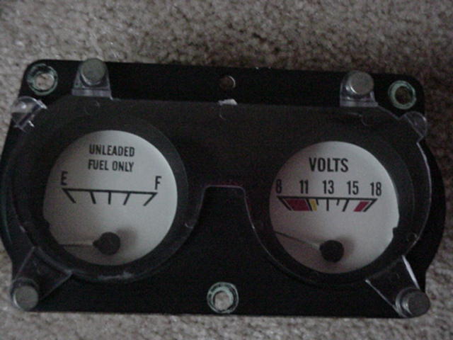

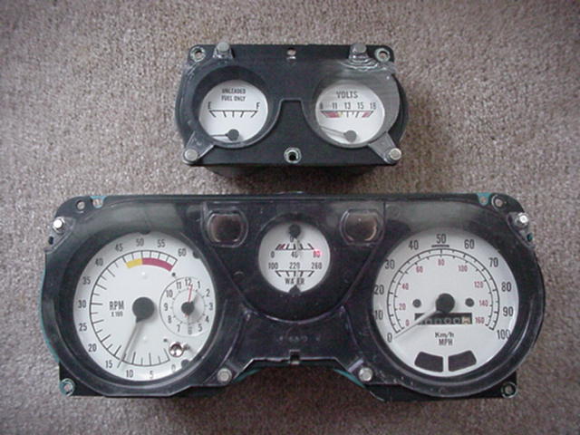

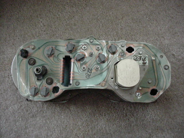

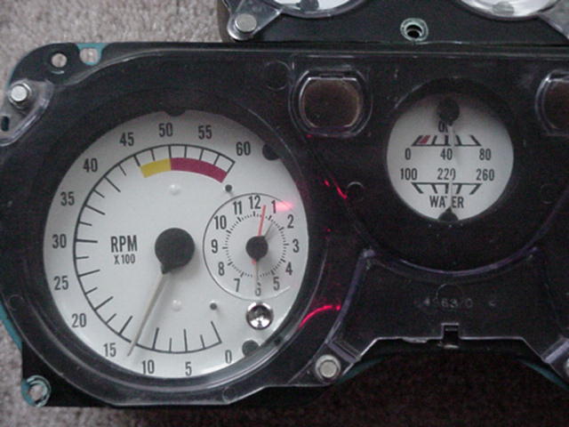

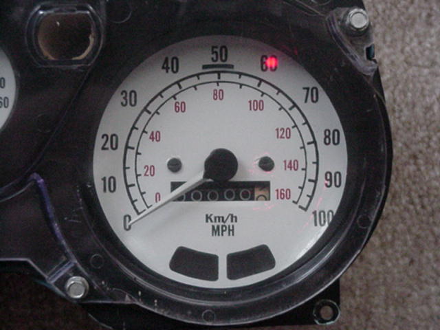

Chuck I have a set of white faced gagues right here. The odometer is also set back to 00000. Let me know what you think. I am not putting them in my 74 so they are on the market to be sold. If anybody wants them, make me an offer and we will go from there.
