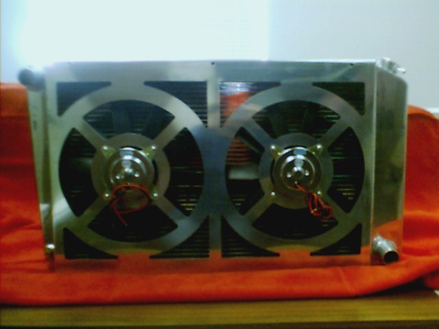

What year FB do you have? We make a dual or single fan system from laser cut fan shroud. THe stock system is almost always best, but there are many reasons one chooses to go electric. From what you describe, your radiator is just not efficent enough, so I think you will be fine with our radiator and electric fans.
Heres a picture of our dual system.
Jerry

But your system probably won't fit my 71 T/A as there's the cross brace that runs vertical in the the front of the a/c condenser - right in the middle.

It should, our 75 is an AC car.
THe fans are on the engine side.

The dual system is $395. It is laser cut and polished, and includes the thermal switch.

Can you still use your stock shroud on a 70s T/A?
I never even considered installing a fan/s on the engine side. You mean you can toss the stock fan and clutch or do you retain them for more airflow?

I use a single fan for the 69, $325. The radiator is $510 auto $475 manual. with the complete system I ship free and include a billet radiator cap.
