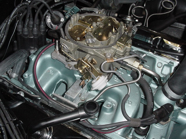

<BLOCKQUOTE class="ip-ubbcode-quote"><font size="-1">quote:</font><HR>Originally posted by RAJ7395:
JUST LOOK AT THE PICTURE!!!!!
The red striped hose goes to the manifold vacuum source, the long black hose goes to the distributer vacuum advance bell and the short hose attaches to the tube which goes into the timed vacuum advance carb port.<HR></BLOCKQUOTE>
...What Red Hose? Where is the Black Hose?
Which one connects to the Pink Elephant?
So much for a picture being worth a thousand words.
((very nice detailed picture btw))

Old 06-18-2003, 05:19 PM
RAJ7395's Avatar
RAJ7395 RAJ7395 is offline
Join Date: Apr 2000
Location: Peoria, Illinois USA
Posts: 1,678
AH NUTS!! I got caught with no date code on my breather tube. Bad monkey, Bad!! Feels about the same as getting caught with your fly down in church.
My TA was missing the breather tube when I bought it so I picked up a repro piece and slapped in on. The darn thing started to rust two days later so I took it back off ahd painted it dull black. I've never seen an all original restored TA up close so I had no idea that the date code was stamped on the breather tube. Do you know date code format and the letter size?? The number might just magically appear..

Old 06-16-2003, 12:19 PM
Tripowergoat66 Tripowergoat66 is offline
Location: Tacoma, Washington, USA
Posts: 174
69's are basic..just 3 hoses. one to ported vac, one to man. vac and one to distributor adv. The other two are plugged off.
Old 06-13-2003, 08:20 PM
RAJ7395's Avatar
Join Date: Apr 2000
Posts: 1,678
Here is a picture of the vacuum lines routing on my 69 TA. This car doesn't have A/C but does have an automatic tranny.

Old 06-18-2003, 11:10 AM
steveK steveK is offline
Location: ny,ny,usa
Posts: 1,067
Hey Raj...your crankcase vent pipe ain't date coded on the right side at 125 degrees from top dead center. That's 2 demerits :-)

Old 06-16-2003, 01:10 PM
RAJ7395's Avatar
Join Date: Apr 2000
Posts: 1,678
The red striped hose goes to the manifold vacuum source, the long black hose goes to the distributer vacuum advance bell and the short hose attaches to the tube which goes into the timed vacuum advance carb port. I verifed this lines routing with the 69 assembly manual and my car runs great fine.
