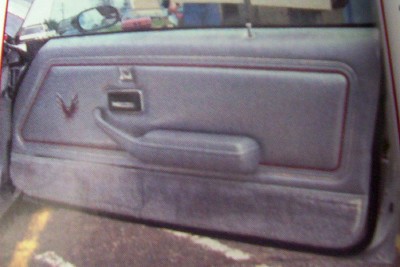

A deluxe style interior door panel will be padded and have carpet along the bottom with a pocket in the carpet near the front and a strip of chrome running in an almost circular shape on the door panel that surrounds the door handle, arm rest, and etc. The seats in a deluxe style for 78 will have the "pillow inserts and pleats going across the seats.

here is a deluxe door panel

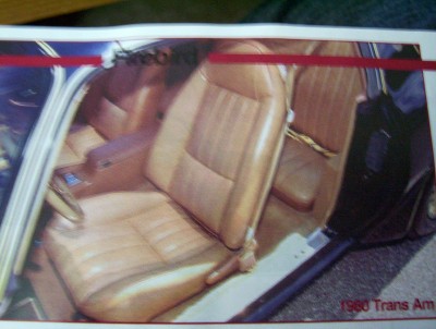

here are the standard style seats

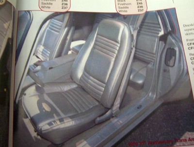

here are the deluxe style seats
