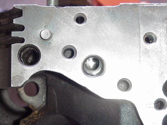

In case you are interested, here is a shot of the oil passage (pump entry to block) on my 1970 Pontiac 400. Every passage in the engine, including the filter housing and oil pump body is enlarged and polished.
The lifter galleys are drilled (3 foot long bit) and then reamed to final size. This eliminates the 'uneven' bulkheads you often see when looking down into the passage.
I've tried every kind of oil you can think of including Royal Purple (used to be marketed in the 1950s as Royal Triton and it was purple then too) Amsoil, RedLine and Mobil.
I've never had the consistency in oil pressure with a thin oil. I just don't use them, so there is more for you guys... ...Robert

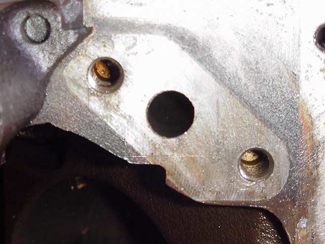

And, just in case you are interested, here is the same passage in my stock 1979 400 block.
And by the way, I guess I am very anal about this kind of stuff, in case you didn't notice...Robert

Robert,
Very nice..! What did you use after the three foot drill bit (to ream)?
Buy a GOAT....they eat anything!
Old 08-20-2004, 11:08 PM
Z Code 400 Z Code 400 is offline
Location: Fresno, CA. USA
Posts: 5,307
Bab,
My Dad had a bunch of reamers. All kinds...most of them were for toolmaking. I found one that was adjustable and had a pilot. It was also about 3 feet in length.
When you looked down my oil galleys, you could tell my black had suffered some casting shift, since the passage was not straight.
I drilled the passage until it was straight and used the reamer to 'clean' up the surface.
I then asked my Dad to make an arbor for the cartridge roll that is about 3 feet long, so I was able to polish every passage to a mirror finish.
I also have flush-fit taper-back 3/8" pipe plugs from a 429 Ford in place of the front oil gally 'knock in' plugs.
Dad's been doing this to Flathead Fords for 40 years and I grew up around those engines. I just apply the same technique to this 413.
It's probably not necessary, but I like the way it works and looks. Much better oil pressure with less than 15 PSI change between idle and 3000 rpm.
Most passages are shaped and polished with a cartridge roll in a 3/8" electric drill.
E-mail me at [email protected] if you need more information...Robert
