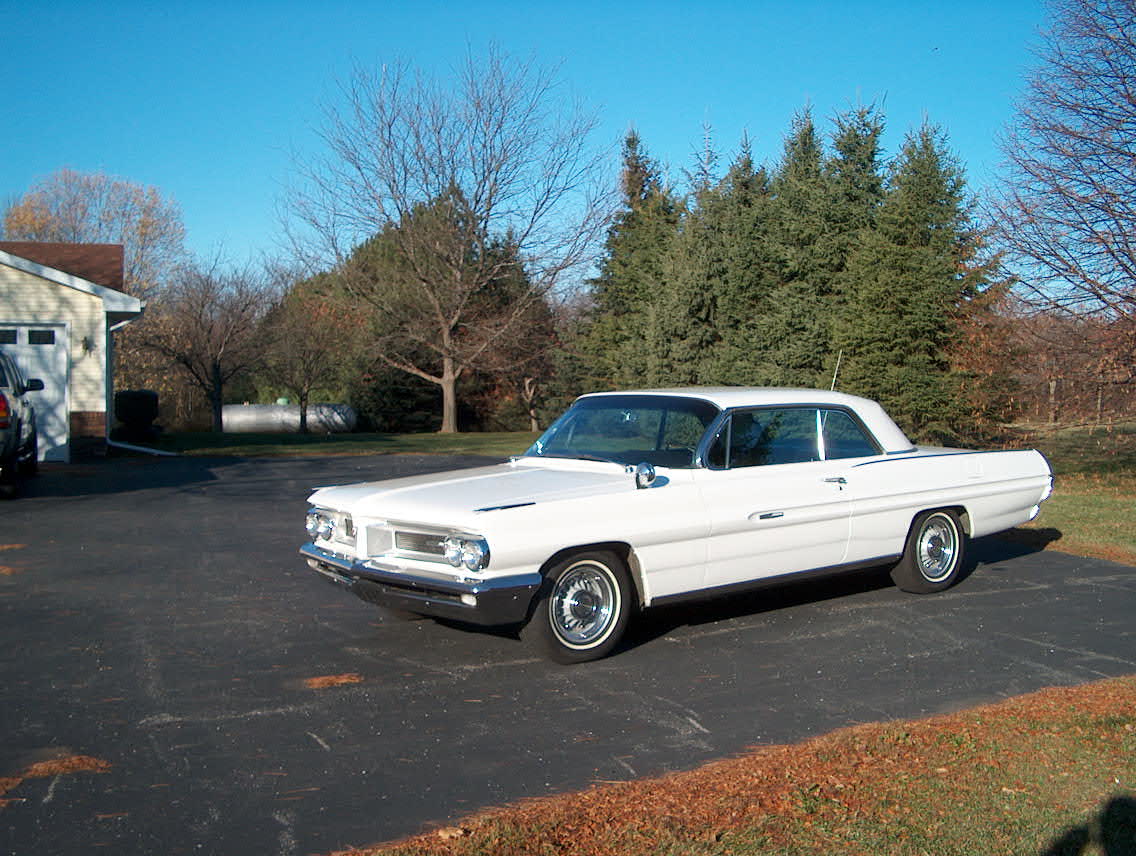

Thanks for the info. The spindle's were my main question. I have an older style set of Torque-thrusts that I want to put on car. I think they will look sharp. Now I just need to decide which conversion kit to go with. Any advice?
Thanks again, Ken

Stay with the 8 lugs.......... Your car looks great with them......

Not to discourage you from going with the torque thrust, but the 8 lugs rims are really cool and your car looks bitching as is. This is coming from a guy that has 17's on my 67 Lemans and 18's on my 72 442, so I'm into aftermarket rims.

That's crazy talk man!!!!! As a proud owner of a 65 Cat with the 8-lugs, I can honestly say that NOTHING looks as cool as 8-lugs!
