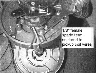

<BLOCKQUOTE class="ip-ubbcode-quote"><div class="ip-ubbcode-quote-title">quote:</div><div class="ip-ubbcode-quote-content">What distributor do you use for ignition control, the 301 computer controlled HEI ones? </div></BLOCKQUOTE>
This is an excerpt from "CUSTOMEFIS Custom Engineered Fuel Injection Systems WWW.customefis.com
How to build a GMEFI System
Written by John Wilsom
Published by Custom EFIS
First printing 03/03
GM HEI DISTRBUTOR CONVERSION TO COMPUTER CONTROL
IGNITION
The first task to accomplish is to get a GM ECM to control the ignition timing. This task is critical not because you have to control timing with the ECM, but because the communications from the GM ignition module to the ECM are absolutely necessary for the ECM to begin controlling fuel. Fortunately, this is a relativity easy task as long as you already have an electronic distributor with a magnetic pickup. There are two different styles of ignition modules you can use. I’ll call them the Corvette style and the Camaro style (also called a 7 pin and an 8 pin module respectively).
The corvette style is best to use when converting a GM HEI non-computer distributor to computer control because the ignition module is mounted inside the distributor cap and gives a factory look. The Camaro style is the best to use on a non GM distributor because the connectors are weatherproof and have a good seal from the elements. For those considering using a using a stock small-cap external coil distributor for your project, you may want to reconsider. I receive a lot of these distributors in the used systems I buy and they are usually corroded beyond repair. Occasionally I will get a decent looking one, but for the most part, they wear out much faster than the HEI style. The following section provides instructions for converting your distributor to GM EFI computer control.
GM HEI DISTRIBUTOR CONVERSION TO COMPUTUTER CONTLOD
This section describes how to modify a GM HEI non-computer distributor such that a GM EFI ECM can completely control the ignition timing. This conversion is the cleanest since the ignition module is mounted inside the distributor for a factory installed look. The first step is to buy an ignition module for a 1985 corvette or any other GM computer controlled HEI distributor (you can also buy the Corvette magnetic pickup coil and get a better installation, but this is optional). Remove the cap and rotor on your distributor and then remove the non-computer ignition module and the power connector and noise suppressor condenser. Once these parts are removed the removed, look for the magnetic pickup wires. They are green and white. If you elect to reuse the existing pickup coil, cut the plastic connector leaving as much wire as possible. Then solder a 1/8th “female spade terminal on the end of both wires (See Figure 1)
