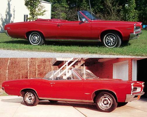

Maybe I can attack this from a different angle. The picture I have attached has my car(top) and a sweet looking gto I downloaded(bottom). I want my car to ride similar to the car on bottom with maybe just a littlemore height in the rear. Can anybody estimate what I need?

How about new springs? Are those original? If so, replace them. If you want the rear higher, you can try springs meant for the same car, but the station wagon body style.

You could leave the rear end as it is, and cut half a coil out of the front springs.

Inch or so you can use rear coil spring spacers or coil over shocks, stay away from wagon springs too high!and air shocks ride too hard!

You could use air shocks that use the little hoses that connect to an air valve. All you do is pump air in, and the rear comes up. Costs about $60 for both shocks and about an hour to install. The kit comes with all you need. It's also available over the counter. I put some on my Cat, and it got the ride height just right. Also, the ride is quite nice as well.

Stock replacement springs if you want it to look like that GTO, station wagon springs if you want it to sit too high.

If you want it to look more aggressive, I'd still use stock springs in the back, and either shorter or cut stock springs in the front to give it the rake. Mine looked almost identical to the pic of the GTO you posted, and I'll be cutting my front springs this week. Unfortunately, I wont have the entire car back together for some time, so I wont have any pics for you to look at.
Also, the higher your center of gravity, the more your handling suffers(and these cars aint exactly the best handling cars on the planet anyway!)

You could look in the back of the Moog catalog for the specs on your stock springs (wire dia, free length and rate). Then try to find the same style spring that has a similar wire size but is taller or same free height but a little larger wire diameter. Don't do both though as you will have the ass end a mile in the air.

i would think that variable rate(cargo coil)springs would be his best bet. i never liked the look of the ass-end being lower than the front end.

Your front is really close to the other cars height. Maybe an illusion but the other car has a lower profile tire with 15" wheels. Yours appears to have 14" wheels and a taller tire. The only difference I see is the rear. I think new rear springs will do the trick.

How about lower profile tires for the front as well as the new springs for the rear end? How would that look?
