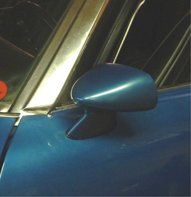

The 1970 GTO did not come with bullet style mirrors. A basic chrome manual one was standard on the driver's side, and you could get an optional chrome remote control mirror. The passenger side was bare unless you had a dealer put one on for you.
The bullet style mirror did not appear on the GTO until 1971, so what you have been seeing is alot of folks adding them to their 1970's (because they look cool). I'm eventually going to add them myself and keep my original remote mirror in storage for originality sake.

Here's an example of a bullet style mirror on a 1970 GTO (not mine, but representative of what folks are doing). These style mirrors were most common on Trans Ams and Grand Prixs of the 70's.

the 1970 GTO could be had with the driver side chrome remote or standard mioor only, the mirrors you are referring to were started on the 71 and up GTO
