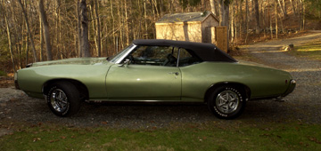

Trying to show a picture of the patient. First time trying this, lets see if it works›

Awesome ride. [img]/infopop/emoticons/icon_cool.gif[/img]

Nice looking car goatless! So you're not really goatless after all! [img]/infopop/emoticons/icon_wink.gif[/img]
