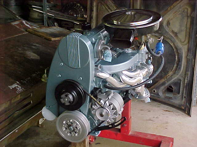

Nice to see a OHC posting! I have recently rebuilt my Sprint motor for my 67 Firebird Convertible. Parts can be difficult to locate, and are a little on the expensive side. But the "wow" factor and performance is impressive for a Inline 6! E-mail me if you need parts sources, specs, advise, etc... : [img]/infopop/emoticons/icon_biggrin.gif[/img]
Old 11-07-2002, 08:36 PM
A455GTO A455GTO is offline
Location: PACIFIC NW
Posts: 278
Now that's a purty motor, even if it's missing a couple of cylinders! [img]/infopop/emoticons/icon_wink.gif[/img]
