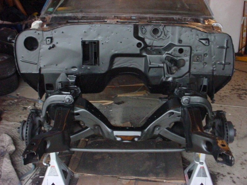

Here is a pic of my firewall and frame after I painted it. Looks good enough for government work.
http://community.webshots.com/user/69gtodude3e
