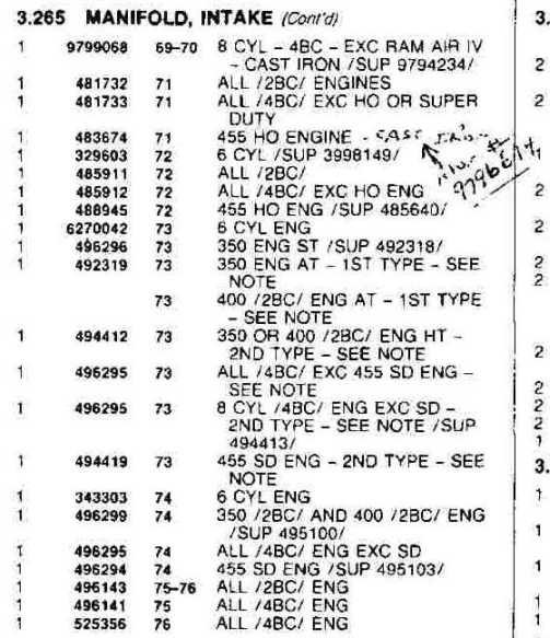

and . . . here is a scan from the June 1977 MPC, showing the that the 488945 manifold superceded the 485640 piece.
I have been speaking with Rocky Rotella about this information. Rocky has archived several pictures of BOTH '72 455HO intake manifold castings, and they appear identical.
My theory is that the casting was altered, however slightly, when the 7F6 cylinder head casting was changed from the "scalloped" intake manifold gasket interface to the non-scalloped design.
Whatcha think?

That is the number on my intake "485640" snd it is the original intake.

I also have a early 72 T/a, and that is the number on the manifold also.

The 485640 intake manifold is CLEARLY NOT any kind of "experimental" piece!!!!! See above scans I posted out of OLD Pontiac Master Parts Catalogs.
Once again - the Dec. '71 MPC scan shows the 485640 PN, and the June '77 MPC shows the 485640 being replaced by the 488945.
My Nov. '71 build date '72 GTO WW5 455HO car has the original 485640 casting intake on it.
There is NO DOUBT that the 485640 SD intake being an experimental SD piece is PURE MYTH!
