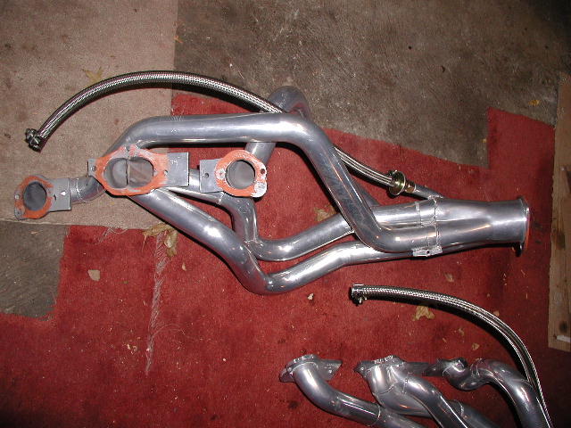

I'm looking forward to installing these on my new motor! I was told they are very easy to install! Plate bolts to head, then each individual 2" tube gets mounted to plate, with the last having the 31/2"collector...then remining tubes bolt to collector. We shall see! Thay are Mad Dog headers BTW.

Old 02-18-2005, 04:00 PM
Jagtec1's Avatar
Jagtec1 Jagtec1 is offline
Location: Bryn Athyn, PA
Posts: 4,815
Another

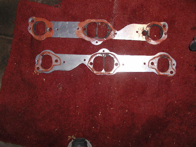

Last one, these are the flange plates. Best part is....no header gaskets!

http://www.geocities.com/maddogheaders/
I think you can get them thru Nunzi also. I bought mine used from a local racer, who used them on his 70 Lemans Sport. I paid $375.00, they are Jet Hot coated, and came with the evac setup you see in the pics. All hardware and flanges were included as well. Here is an uncoated set on E-bay for 64-67 GTO.
http://cgi.ebay.com/ebaymotors/ws/eB...tem=7954741348
It says they normally sell for $475.00
