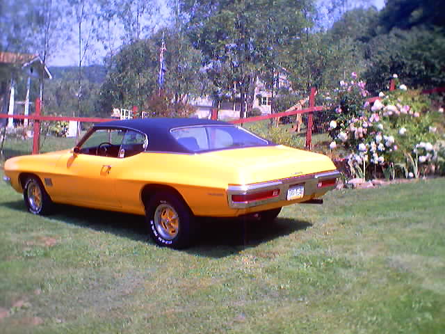

Nick,
The tread patch is 9" the tire is 28" tall
I have mine mounted on ralley II's.
Here is an old pic to give you an idea on fit. I'll get you a better one once the rain stops.
Patrick.
