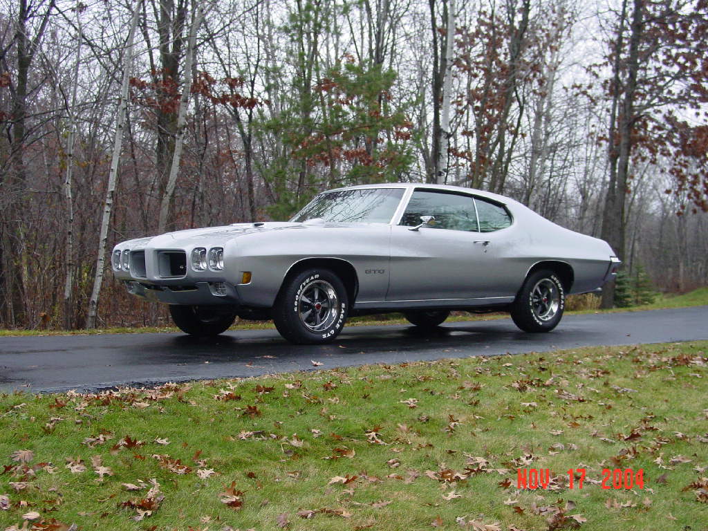

after swapping out a couple different sets front & back, I finally decided on a set of "firm ride" moog springs through amesperf for the rear.......& put a set of stock replacement moog for 70 gto with a/c for front. I was told since I do not have a/c ,this will give me about 1/2 inch over stock height. for tires I am running 15 x 7"s with 235-60 series. I am very pleased with the stance. good luck with your choice...BTW @ rocker front 11 inches....@ rocker rear 11 - 1/4 inches

I took your info and ordered the same for my 70 GTO, put them on today. Great service from AMES. Big improvement on my car, looks better and gave me another 2.5-3" clearance and handles much much better. Really like your paint job, where did you get it and what is the paint info? With my blk interior, I may look to go that color next paint job in a few years,

thanks for nice response clubber I have sprayed both base coat/clear coat to the tune of about 400 units per shift, for 16 years @ twin cities assembly. (ford ranger)except for pro rebuild of original motor, I restored entire car @ home. I think there are better silver shades than mine, but this was available @ heavey discount thru a friend @ work. it is code "yn"(ford color ) titanium. dupont chromobase/dupont 7500 clearcoat.
