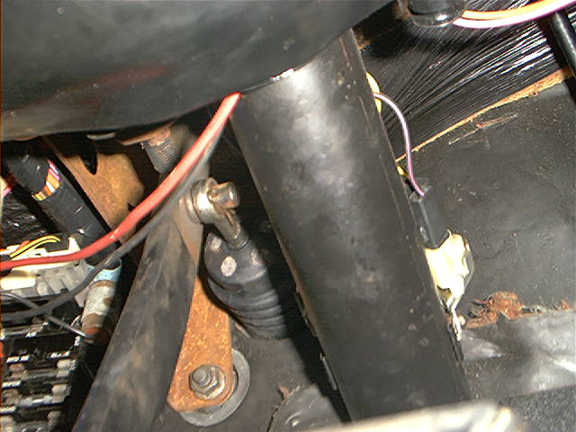

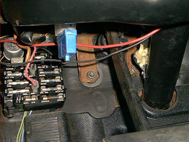

Thanks. Before I read this- I had to take the car to a local repair shop where a mechanic that my dad knows well said that the replacement booster was also bad. So, I got another and installed it last night (Friday night) and plan on bleeding them tomorrow (Sunday). I did not have time today. We did finally get fluid going through the front brake lines. It was where the original brake lines are so old, that the bleeders were stopped up or something.
One thing that is very puzzling now is that the new booster I installed last night seems to have much smaller bolts, as I had a hard time getting some of the nuts started on them. I had to tighten the lower bolts as tight as I could, in order to even get the upper bolts to get a grip on the threads. I was not about to remove the booster again to see if they were indeed shorter, but I guess that it all it could be. I am guessing that they installed smaller bolts on this particular booster?
This was one of the exact reasons why I was hoping and praying that it was not my booster that was bad, because I had a feeling it was going to be a headache. I was so agitated with it last night, I was ready to give the car away. I have not even been able to drive the car for 3 weeks (aside from driving it to the shop the other day with no power brakes - which was interesting).
Hopefully after I bleed them tomorrow, it will be OK. If not, I am tired of fooling with it and I will sell the car before I remove the booster again. I just do not like working on cars on spots I cannot easily get to. I have no idea why they did not do these like they did on the older Pontiacs (or so I have heard), where you can simply unbolt them from the outside, as the firewall holes are threaded and the bolts go in from the outside- which makes more sense to me.
Thanks again.
BTW- Here is a photo of the bolts after I installed it. See how the bolts coming though seem too short? The booster is tight, I know for sure, but it just seems like something about it is not right. Seems like the bolts on the booster should be the same length as the originals.

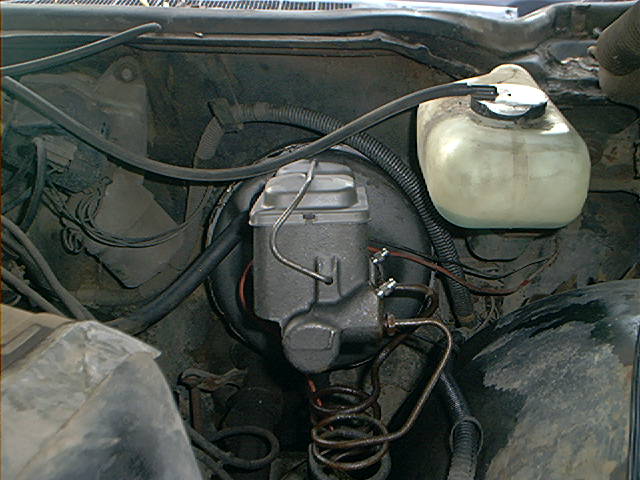

Also noticed I forgot to update. That first booster I replaced was not only too big, it was defective. I had to end up getting a "bendix" booster for a 72' model, because it was not listed for the 73s. I then put that on and that was when I had no "power brakes", then took to the shop. He said it was bad too. So, that took me to the above posts.
It has really been a headache.
Here is a photo of my original booster after it was removed:

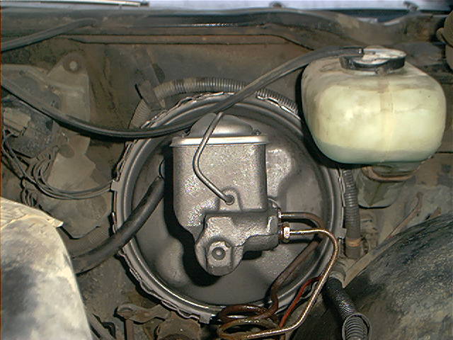

Here was the 2nd replacement booster- this booster was not listed as available for the 73' Grand Ville, only the 72. This one was also defective- no power assist.
The latest one I installed, looks just like the above booster, but as mentioned- the bolts seemed much too short. Much shorter than it was on the others.
