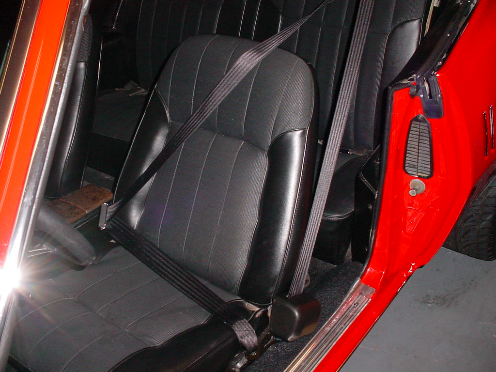

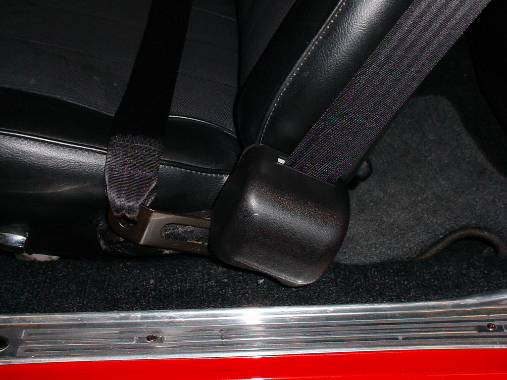

I just received my belts from Morris Classic Concepts and put them in tonight. They bolt in perfect and easy. They are comfortable coming across the shoulder, a little close to the neck, but without a guide mounted to the seat itself, there is no way arount it. The retractor does end up resting against the door panel, but it is not tight.
These look very similar to the universal ones posted above, but the mounting bracket for the retractor is made to clear the seat.
The only issue I had was I could not use my seat extenders as with the seat pushed back, the side hinges would hit the retractor.

Camera's back up and running. Here are a few shots of the new belts....

Close up of the retractor

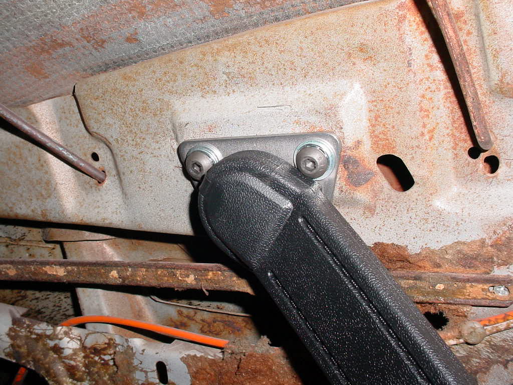

Posts: 389
Upper attachment at the roof.
Very easy for me as the headliner is out.
