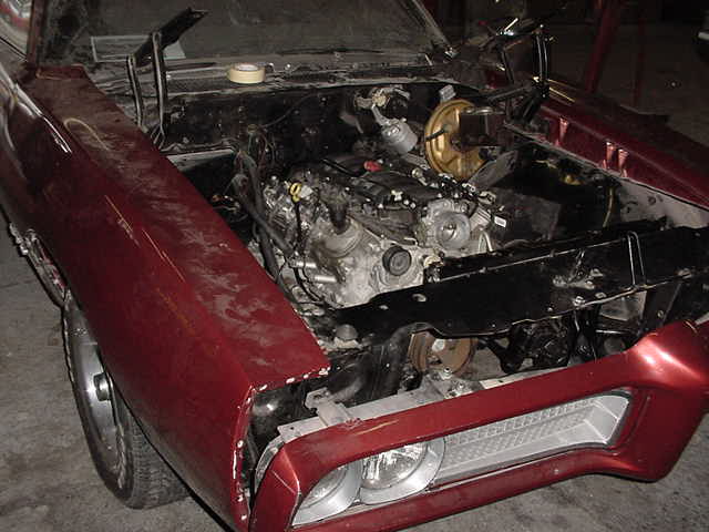

Well after a little waiting I finally recieved my modified oil pan from Street and performance. With the oil pan installed and S&P's motor mount brackets, chevelle frame and motor mounts it sits like it was born to be there. The picture attached was from a couple of days ago, before I put the 4L60E trans back on. Sorry I don't have a current pic but the LS1/auto combo now resides where my 455/4spd with no problems --- yet. I am still in the beginning. Its getting real exciting real fast. Sorry the pic is kind of dark

Well today I put most of the front end back on to see how much more I need to cut the front springs. And as I suspected a one coil cut was not even close to enough, so tomorrow they come back out for more. Also my Rock Valley tank arrived the other day and looks great. expensive but great! Once I get the front end together and the stance correct, I will be in a holding pattern, until I can get my new driveshaft, exhaust, wiring harness and a couple other things I am waiting on.
NEP, I live in central Illinois, and the 455 has been filed under CF, for catostrophic failure. I'm not sure if you can sleeve a pontiac block but when it blew it took most of the cylinder wall with it. However there are some other parts from it if you are interested.

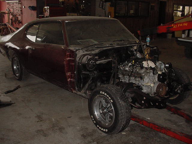

The last couple of days I have been rebuilding an automatic shifter assembly and prepping to dye the console black. It really works out great when you have an uncle restoring an orbit orange 70 judge with a couple of parts cars to trade with. So I have disasembled the whole shifter, blasted every part clean and painted semi-gloss black. If you did not already notice this is not a concourse resto. ha I will be reassembling it monday as well as looking into the trans tunnel. I forgot, even though it was originally an auto car the tunnel was modified for a 4spd and console before it came to my family and finally to me.
Also this past week I routed the LS1 throttle cable witch turned out to be alot easier than I thought. After a little work with a small file it clipped into the fire wall and the slack coming out was nearly perfect. All I had to do was fab up a small bracket because of the way it attaches and that was it. So hopefully this week I can get the shifter together and the tunnel worked out and the interior work will almost be done.
To answer some questions, I am still working out the trans mount, it is currently just resting on the original crossmember. There have not been any clearence problems with the steering shaft or brake booster. The steering shaft is sort of close, but I am still considering exhaust options. Street and performance is building a set for their 70 chevelle that should work.
Oh, I ended up cutting 2 full coils off the front springs in all and am happy with the way it sits right now. We will see after the first drive if it is too harsh and needs to be changed. Here is another pic with the front partially assembled. If you guys would like to see certain pictures do not be afraid to ask. If I don't already have one I most likely should and its not too hard with the digital.

Its almost done. Sorry it has been a while since the last update but I have been busy. Everything is done almost except the exhaust and the replacement of the recently discovered broken radiator. I have been promised the new radiator by Wednesday and hope to fire it up that afternoon.
In the attached photo you can see just a couple of things that I have been doing. First the very simple air intake setup, which some like and some don't (I personally like it) consists of a LT1 1LE package intake elbow, modified mass air, large K&N filter and very simple aluminum bracket. In the back ground you can see my relocated alternator and the mounted computer. The alternator ended up on top, which is fine with me. I took a couple of extra hours to plan and do but saved me a few hundred dollars over the Street and Perf alternative.
Nic, no I did not replace the frame with a chevelle frame, aren't they nearly identical anyways? I did have to use chevelle motor/ frame brackets that mount to the frame.
Robinb, the modified pan and pick up cost about $250 plus sending them my pan as a core. As for the exhaust, I have a set of street and performance headers, and a 2 and 1/2 inch flowmaster system. As for the drive shaft, my new 3.5 inch custum aluminum shaft fits beautifully, sorry I don't have a pic.
