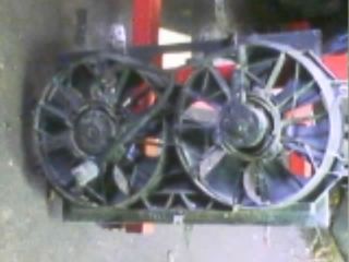

They are a double fan all in one shroud. The harness for them is also a 1 piece unit, and it doesn't use the balasts that so many do. They, like others listed, have incrdible amount of airflow. I choose the Chryslers as their v-6 run pretty hot and over the years there fans just kept getting more and more powerful, and the fans are in so many cars that they are pretty easy to find.

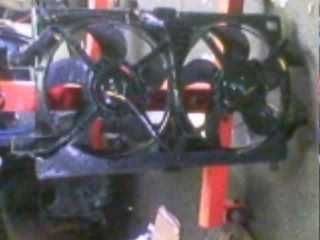

And here is the other style (Which I think is a little better but requires a little more clearence).

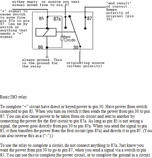

Do you mean phsically locating them or wiring them up?
I wire them up with a themostat switch run through a relay.Can post a basic diagram for that if you need it.

Wiring them up, I like what was posted looks like a good way to save on horsepower.Also would it be better to locate the fans in front or behind the radiator?

Mount them behind (the engine side) of the radiator. As for wiring them here is a basic relay diagram.Pretty easy to wire anything once you understand a basic relay.
I am just attaching what I made up for a couple of my friends so they would quit wiring everthing straight to there battery or fuse boxes.
---"Reverse-engeneering will always make up for the lack of original ideas!"---

Thank you for sending the wiring diagram and location to put the fans, it will be another project that I can do to improve my car to make it a better daily driver when I get it on the road.

I just picked one up today from a '95 Chrysler New Yorker. Looks like the one in AndyR's second pic. I think it should mount fairly easily to my '68 Bird's radiator support. It's even equipped with a a 2-speed module. Bolt hole spacing is 28 1/4".......the same width as my radiator!!!
