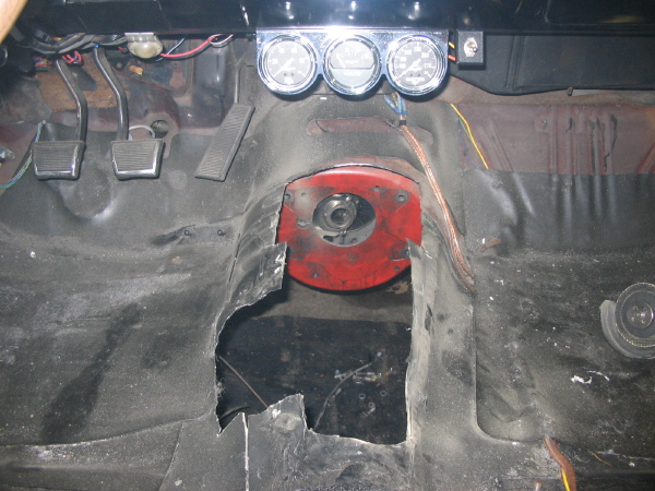

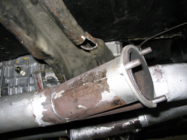

First I removed the front half of the interior including the seats, sill plates, kick panels and carpet. I then jacked the car up as high as possible to allow for ample room when removing the old trans and for installing the new. I placed the jack stands under the rear axles and under the front spring lower A trays. Next I disconnected the exhaust which is an aftermarket system. Then I removed the driveshaft followed by the shifter and then the Supercase Muncie. I decided to leave the clutch assembly alone at this point because it was working just fine and therefore left the scattershield in place as well.
I then climbed back into the car and traced out the area which I'd need to cut on the tunneling to clear the new Tremec. Tremecs are a little larger and boxier then Muncies so this part is necessary in order for it to fit. Once traced I proceeded to use a 4" hand grinder fitted with a cut-off wheel in cutting the tunneling.

After the cutting:

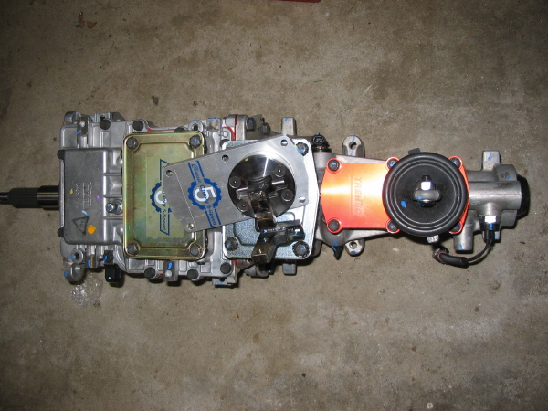

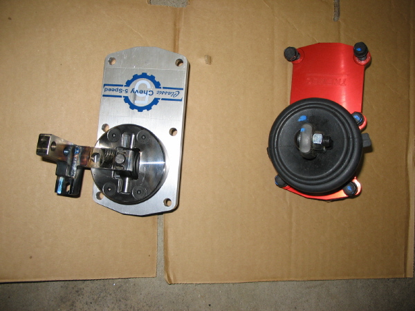

Here are some picture s of the trans and the offset shifter I bought. I bought the offset shifter and am glad I did because it brought the shifter to the proper location for me to shift and if I ever decide to reinstall my console it would be needed to fit the shifter hole.

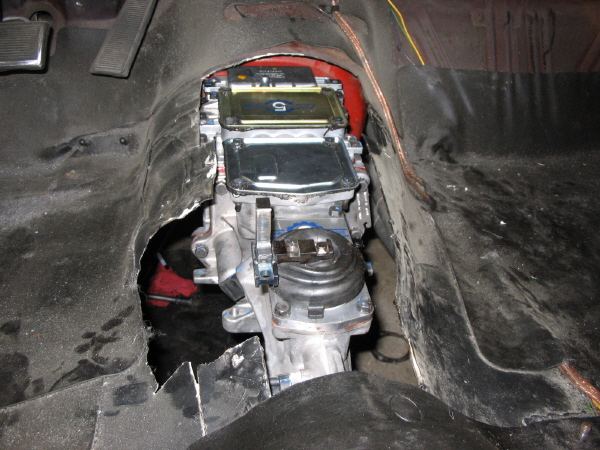

After cutting the floor it was time to install the TKO. I used a floor jack and a lot of muscle to get it in. They're a heavy trans and I wish I had someone there to help me at this point but I managed.

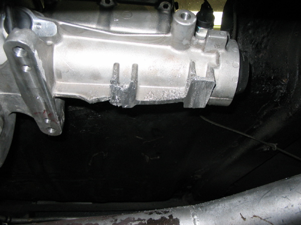

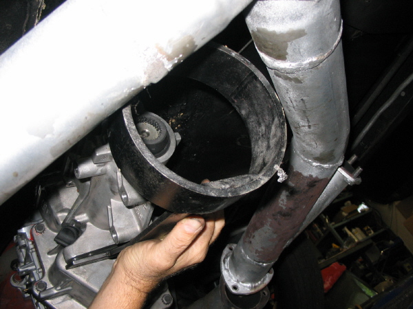

With the trans in place I started to install the Indian Adventures driveshaft safety loop and transmission mount but realised that the boss under the tail section of the trans had to be removed. Out came my sawzall!

another angle
Not pretty but it worked!

The location of the trans mount is just under 2" further rearward so another set of holes had to be drilled in the frame for the crossmember mounts. And because I have headers and cutouts I had to notch my crossmember in one spot to clear the exhaust.

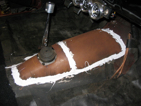

Old 07-15-2005, 05:12 PM
6567GTO's Avatar
6567GTO 6567GTO is offline
Join Date: Dec 2000
Location: Shelton, CT USA
Posts: 2,114
I then pop riveted the new metal in place and spot welded the entire edge about every inch or less. A friend of mine lent me his mig welder for this. After the welding was done I ground down any bad welds and sealed it with body seam sealer.

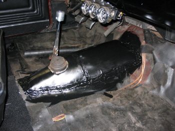

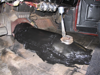

Old 07-15-2005, 05:13 PM
6567GTO's Avatar
Join Date: Dec 2000
Posts: 2,114
I then painted the new sheetmetal with some POR-15

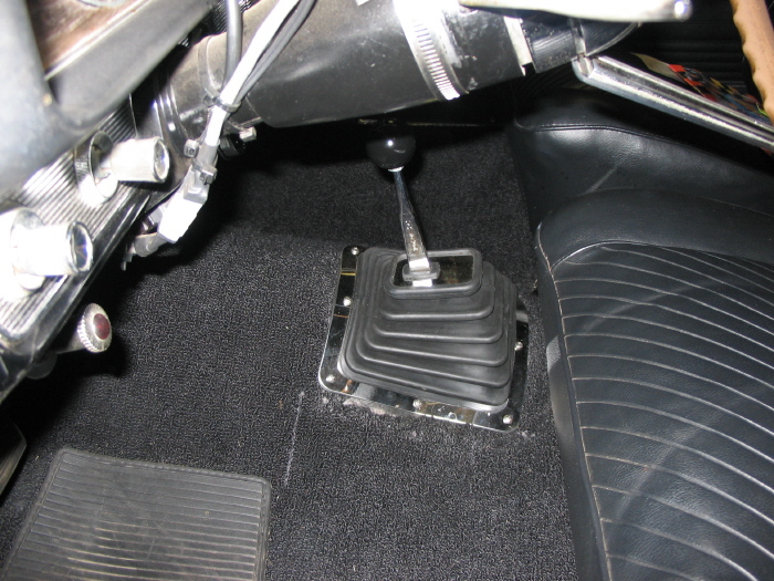

Old 07-15-2005, 05:19 PM
6567GTO's Avatar
Join Date: Dec 2000
Posts: 2,114

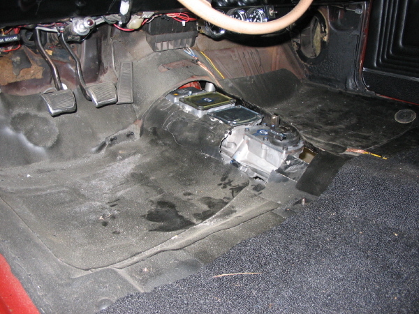

Once it was dry I reinstalled the carpeting followed by the sill plates, kick panels and finally the seats. The last thing to install was a new shifter boot.
