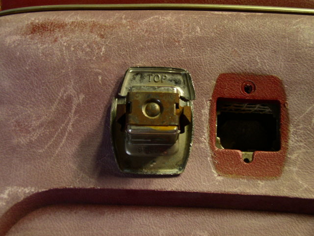

The button snaps into place after the back goes on. How to get it out intact is another question. I'll see if I can get you some pictures as I've got one that is apart.
Here's a hint though, don't pry on the outer trim. It will break. I know.

Here are some pictures. The springs clip onto the sides of the mounting hole and they aren't easy to get out.

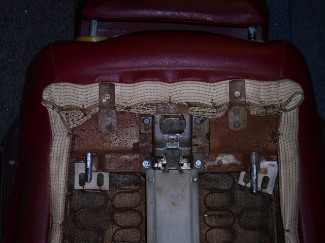

another view

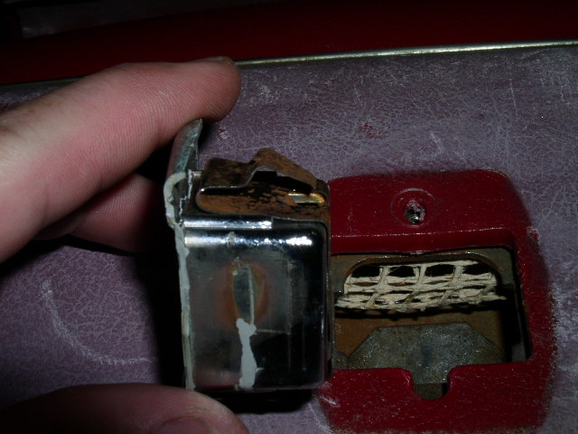

last one

Very helpful pix Teej, Thanks
