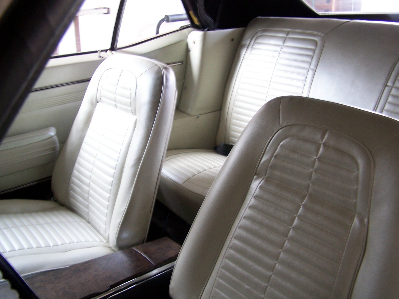

I installed these over the holidays, a huge improvement over the 35 year old originals.

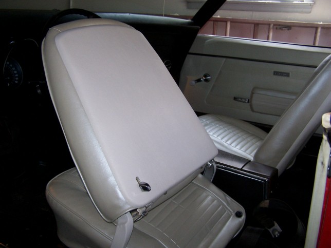

Seat Back, dyed parchment, should have waited to have the Pearl mixed up, but I get impatient.

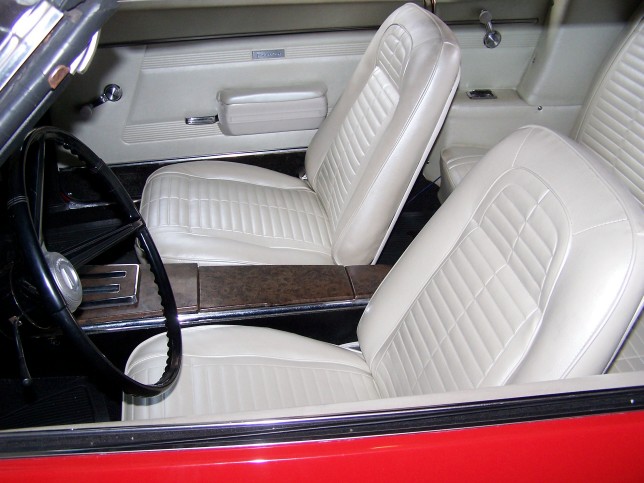

Another

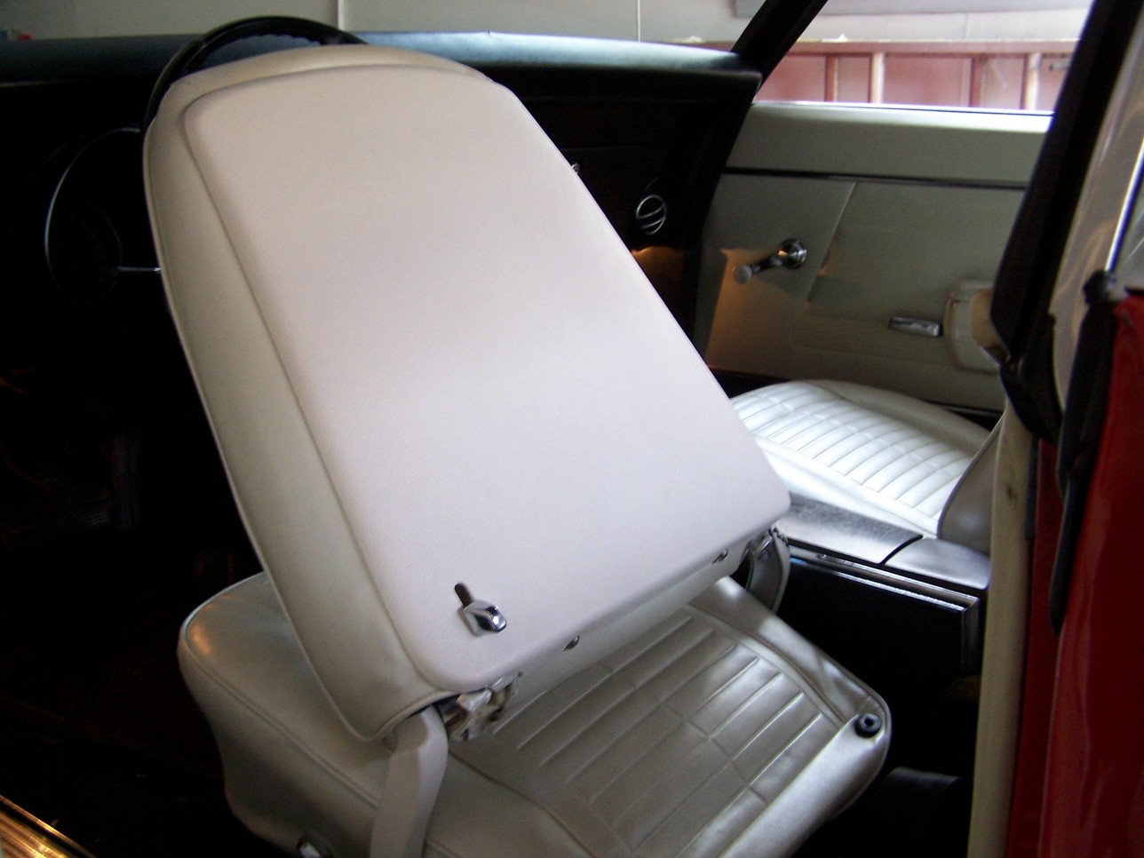

Seat Back

Where did you buy your seat covers from ? What was the "brand". I am about to order a set probably from Ames but still not sure.
Frank.
Old 03-02-2005, 08:22 AM
Mike P. Mike P. is offline
Join Date: Oct 2004
Posts: 65
I bought them from NPD. With the seat buns and springs It was enough to get the shipping for free. PY was the cheapest, but they did not have the color in stock. They are PUI, I think it's the only one available. Overall the quality is good, but the seem split on one of the seat bottoms when I stretched it over the seat. I took it to an upholstery shop and they stitched it back together. The guy said the bobbin did not pick up the stitch at that point so it split. He said it happens sometimes.

Mike I'm thinking about doing this,just how tuff a job is it??What kind of tools are required??
Old 03-02-2005, 02:13 PM
Join Date: Oct 2004
Posts: 65
<BLOCKQUOTE class="ip-ubbcode-quote"><div class="ip-ubbcode-quote-title">quote:</div><div class="ip-ubbcode-quote-content">Notify Tools Reply </div></BLOCKQUOTE>
All you need is the hog rings, hog ring pliers and a heat gun. It was not that tough, but it will try your patience. The trick is getting the listing strips hog wringed in good to get your bolsters to have some contour. Getting the hog rings through the cover, foam, then the material covering the springs and hooked into the spring themselves is a major pita. But if I can do it, so can you!
Old 03-17-2005, 08:53 AM
Droptop64 Droptop64 is offline
On Vacation
Join Date: Oct 2004
Location: Chantilly, Virginia
Posts: 32
Nice Job!!
Old 03-17-2005, 01:05 PM
steveK steveK is offline
Location: ny,ny,usa
Posts: 1,067
Man, did I ever wear the fingerprints off my hands doing that. I finally got smart and got my duckbill and regular vise grip pliers and wrapped the jaws over with electrical tape. This allowed me to strech the material really tight after warming with a blow drier. ....and don't spare the hog rings.
