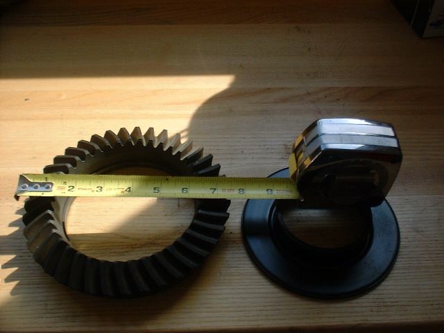

the REAL week link is the ring and pinion gear!IF your going up on HP I would stay with the auto as the converter is like a shock absorber for the diff.I have a Xtra R&P and will post a pic.It is unbelieavable how small they are.Tom

dont you think the factory did EVERYTHING possibel to make the SD trans axles live?Just too small a gear.

that is a pic of the ring gear in relation to a tripower base!ANYMORE ideas?Tom

I was told by a engineer that the other problem is the design is bad for wear,the pinion is at the bottem of the gear.Im going to put 325HP in front of one and am REALLY worried about holding up.Tom
