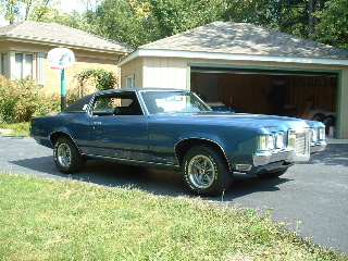

on my 69 i bought 4 15x8 rallyII's from "WheelVintiques" front tires are: 245/60/15 rear tires 295/50/15 B.F.G.'s i think it looks awsome!
really fills out the rear wheelwell.this set up worked w/stock sagging springs,NO RUBBBING! at all.
then i changed springs for a level stance.both front and rear tires measure 26 inches tall.
