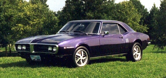

Old 06-30-2005, 12:19 PM
sixt8bird's Avatar
sixt8bird sixt8bird is offline
Location: Snohomish Washington
Posts: 1,163
Here's mine with 1986 Iroc wheels. I used all 4 rears.
