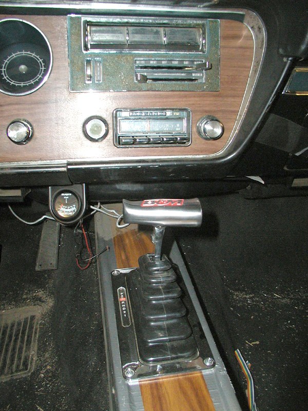

You mean like this:
Les
Les Iden

Les, Your a show off!

I am actually stealing Les's idea as we speak. Also using the quick silver shifter.
Hoping to use the stock cover plate, if I can align it right.
I am having a hell of a time getting the proper height on the shifter itself.

clean install les!! i had the same console with the quick silver and the stock cover plate, took a lil work but it worked out fine.. but that was 20 years ago.

Thumbs up
Thanks for the compliments on the shifter install, it makes the 8 hours of fabbing worthwhile .
Les
Les Iden

Sanitary install man. Looks factory @ first glance, which is the test I use .
Les

I would like to see some pic's.
Worked on it awhile last night...What did you use to shim up the shifter?
I can get it centered, I also have it center into the console, but the rear height is a little difficult, as it wants to sway left or right.
I am also trying to do this with the tranny in the car.

Arrow
Rug,
I also installed the shifter with the trans in place.
I used "lag" screws (normally used with wood) and made the spacers from some old shock bushings. The spacers are tapered to match the tunnel shape and the screws are shortened (cut and ground to a point) once you have the proper length to prevent hitting the trans. Use "star" type locking washers on the screws to prevent loosening.
