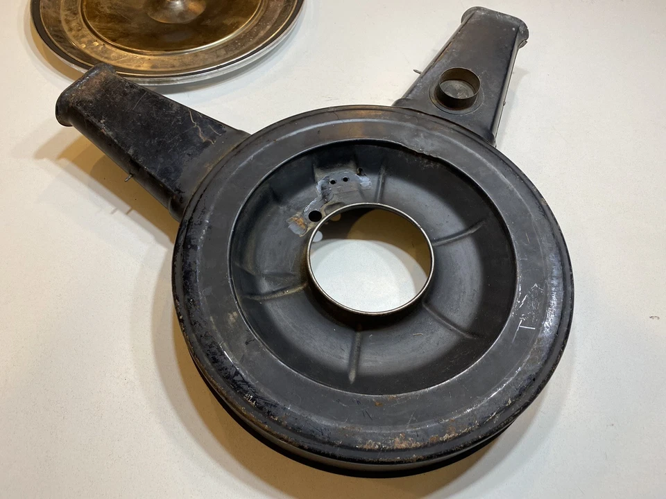

Hi Baron,
I have seen your many comments on early TA's and am hoping you can find me a 70 T/A specialist in the SF Bay Area. By the way, my survivor 70 Ram III has a dual sonklel. Thanks,

Hello George and welcome to PY Forum.
70 Ram3 TA would be a single snorkel .
70 Ram4 TA would be dual.
There were quite a few versions of dual snorkel , but yours would have to be from a specific Formula or TA car , to fit under the hood.
GTO and G.Prix versions don't sit low enough.
This one I am picturing is from a D-Port engine.
Notice that the driver side snorkel has an attachment point on the underside for a heat riser tube that comes the driver side exhaust manifold shield.
Passenger side does not.
The 70 Ram4 TA , and 71-72 TA were RoundPort engines.
They had an attachment point on the underside of BOTH snorkels.
RoundPort engines had an aluminum factory intake with a separate cast iron exhaust crossover in the mid section.
That separate crossover had a shielding over it , and on the passenger side there was an attachment point for a second heat riser tube that attached to the underside of the passenger side snorkel.
RoundPort engines had 2 heat riser tubes , one on each side , each snorkel.
Dport engines just had 1 heat riser tube on driver side.
If yours has attachment points underneath on Both Snorkels - it's 71-72 TA
Only on 1 Snorkel - it's from 70-72 Formula

It is mot not my intent to come off as contrary;
I thought I read from reputable sources that although most 70 RAIII T/A’s left the factory with single snorkles, some legitimately had dual snorkles?
I would think that:
dual snorkle + single heat riser + shaker tabs = legit RAIII dual snorkle.
Maybe I am misremembering that some ‘70 RAIII T/A’s had RAIV shakers from the factory??
1970 Formula 400

I recently bought 70 TA from a 46 year owned reputable owner and he told me that the double snorkel was true to the car.

Will my double snorkel air cleaner have dates/numbers that will match the car?
Old 07-22-2025, 12:38 PM
It will have an ink stamp date code on the inside or the bottom.
I forget now exactly .
In the 80s we were putting 71-72 dual snorkel pans on 70 TAs for the look.
Still have one on mine.
Everybody would rather have the dual snorkel for looks.
These days originality mean more.
If one was done at a plant as a goof , then it was a goof.
Have never seen a nice original well kept 70 Ram3 TA with a dual.
Always a single.
Never seen a dual with a single heat riser and factory tabs.
This late in the game I wouldn't trust anything , the tabs have been repopped.

In restoring these bases, I have always examined the spot welded on tabs on questionable '70-72 TransAm shaker bases to see if the tabs were factory installed with small spotwelds, brazed on, or sloppy spotted with a MIG.
A thought... quite a few single heat riser dual snorkle Formula bases have been made into T/A bases over the years. I've only examined one factory dual snorkel T/A base with a single heatriser that had factory tabs which did not appear to be effed with. Very uncommon to run across such a shaker base, nearly all of the '70 TransAm bases I've repaired or restored were single snorkel original RA III bases, two were RA4 T/A bases.
