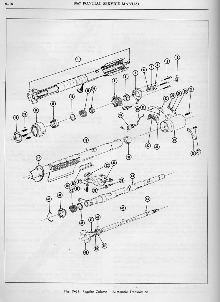

You seem to be short on a bunch of peices.
See below from 67 manual.

You don't appear to be missing anything.
Most of the pcs shown #4-13 from the manual appear to be parts of the sw.

The blowup and pics above are of a '67 column, which is different from a '66 column (no hazard switch). nodwyer - it looks like you have a '66.
