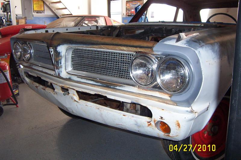

Here is one of my Pontiac projects. It is a Montana car that is faded, but virtually rust free. It came from a Craigslist ad and we traveled 1800 miles round trip to get it. Being from Iowa, there is no such thing as a rust free car over 10 years of age! Plans are to convert it to a solid rear axle (already have an A body Mopar 8 3/4 rear end), put in a 400 ci engine, 400 turbo trans and leave the body as is and redo the interior to near stock. Going for the nostalgic drag car look. Not restored to new, but new "barn find" condition. Plan is to rebuild the front end and add disk brakes.
What is everyone else working on this summer?

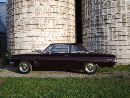

'62pest '62pest is offline
Join Date: Mar 2010
Location: 602
Posts: 74
I am getting my 1962 4 door tempest back together after not wanting to tear it down as far as I did because I never wanted to go this far. When funds are available I am buying all new rubber for all the windows and I need my interior redone. Pictures to follow once the engine is back in so it sits a little closer to earth. I am keeping the 4 cyl 1 barrel carb set up. My vision for this car is more of a factory custom. I have a new paint job and a set of aftermarket wheels from back in the day. If anyone has a really good '62 grill that they might want to let go of, please let me know. I will trade you mine, which is the best looking one I have ever come accross, and a little cash to sweeten the deal.
Old 05-07-2010, 10:14 PM
Hooter's Avatar
Hooter Hooter is offline
Join Date: Feb 2003
Location: Springfield, IL
Posts: 3,868
Originally Posted by 63 tempest View Post
hey hooter what did you used for door handles.
I compared them to the ones on my 65 Lemans and they look identical. Wound up buying a new set for a 65. Haven't tried putting them on yet since the cars back at the chassis shop, but pretty sure they will work just fine.
67 Bonneville ragtop
Old 05-09-2010, 07:57 PM
Join Date: Mar 2010
Location: 602
Posts: 74
i finally got to a computer where i can see what i am doing instead of using my phone. so after the long awaited unveiling here is my '62 tempest that i have been working on restoring with a touch of my own personal taste. i still have a lot of putting back together to do as well as blacking out wheelwells and the front grill area and interior is the next big expense.
