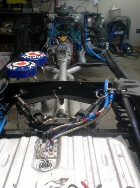

15 years later! In 2017 I switched to a Holley Sniper, and made a gasketed removable plate that bolts into the top of tank, to access electric pump. Also added a return line fitting through top of tank. The factory fuel level float assembly's 3/8" fuel line now acts as an extra tank vent line, routed up to the floor above rear axle, with an inline filter, then goes along frame to open near rear bumper. Also welded in a baffle on floor of tank around pump to keep fuel near it, plus another baffle in rear of tank to slow the surge of fuel up the filler neck on hard acceleration. The fuel smell and leakage is over....for what its worth.
ID:	671038   Click image for larger version
Red\black 65 Grand Prix 467 E-head stroker, Viper T-56 6-speed, 4.10 spool

That’s some impressive work. My current theory is the vent is partially restricted which could increase pressure. I know I checked it out when installed but I didn’t ream it out with a wire and Gumout. I may e able to fish the wire in thru the vent as installed and flush with the Gumout. Worth a try. This primative design had to work OK originally. So we’ll see.

While driving does your fuel gauge seem to read lower than it should...especially on hot days? The fuel tank swelling with vapor pressure pushes the tank bottom down and consequently the float drops with it. Quick test is stop and carefully release filler cap to check for pressure.
