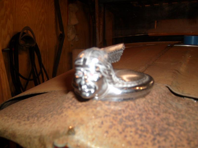

pics from its arrival

When you really do something right it's like you didn't do anything at all
