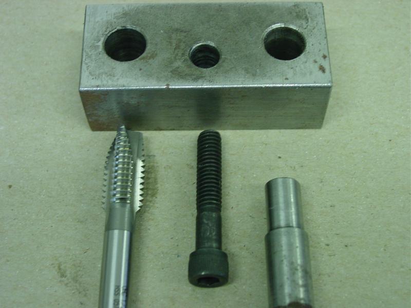

I posted in my thread but thought it might be a good idea to post here too for future reference.
For a stepped shaft for tap alignment would 1/16" under 7/16 and 1/2 be enough off the total diameter of both steps to move freely in the head but yet tight enough to properly center?
1967 GTO, 432 (428+.030), 4-bolt mains, factory Nodular crank, scat rods, icon dished pistons, Lunati HR 243/[email protected], .618/.622 lift, Edelbrock 72cc round port heads, 10.5:1, offy 2-4 intake, Edelbrock 650cfm carbs, Super T10 trans (2.64 first), BOP 10 bolt w/ Eaton posi and 3.36 gears

Turn the small diameter of the shaft to .429" max and the larger diameter to .507" or so to fit your tap block.
The hole in the tap block should be about .510"
1/16" under the nominal diameter is going to be very loose.
Attachment 342107
Dave
I meant to say 1/64th under 1/2 and 7/16, not 1/16. You are correct, that would be much too loose.

Squidward,
The spacing on the tap block is 1.935" but this spacing did not fit each set of holes.
The securing hole is drilled at 23/64" this allowed enough movement of the tap block to do both holes without completely removing the block.
Line up one hole with the pin and tighten the securing screw, start the tap 3 or 4 turns and remove the tap then loosen the screw and align the second hole, tighten the screw and start your tap.
My original plan was to set the heads up on a milling machine and simply run a Tapping Head down the length. Unfortunately the spacing deviation would require each hole to be indicated out as the tapping head has only a small amount of float.
67gtospud,
1/64" is much better and should work fine but the closer the fit of the pin and the tap to tap block the straighter you tap will be.
Dave
