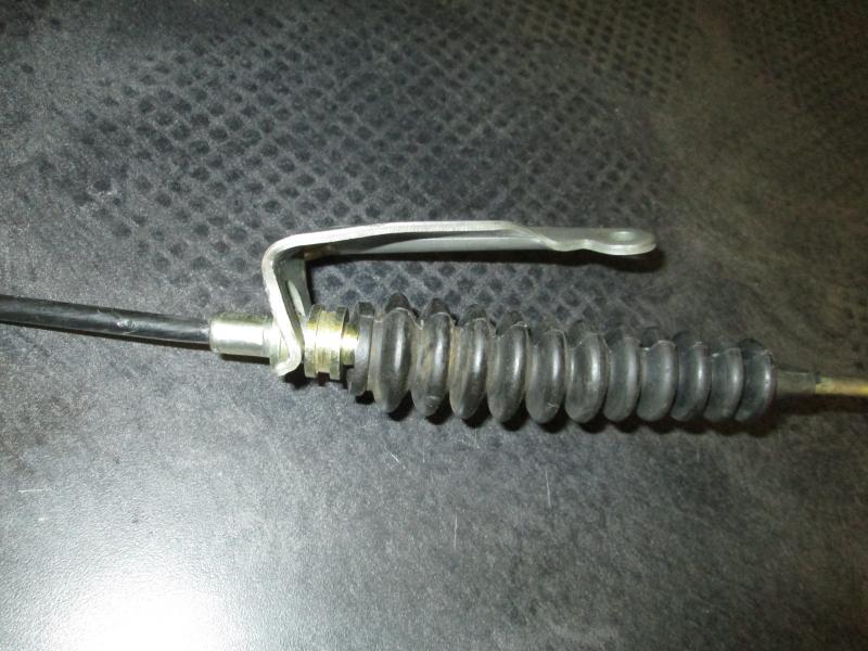

Thought I would jump in here since I was just working on some dual gate stuff.
I f you haven't already figured out, you have to angle the cable housing down in front to get it past that secondary retaining tab. May require some jiggling or little help from a flat blade screwdriver if it has closed up a bit.

Thanks for the tip. I did take a dremel and just slightly ground the corner of the tab. After that it took just a little extra force to pop it in place.
