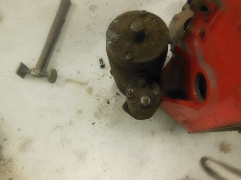

Well.The whole assembly bolted together perfectly and would work very well.Now the bad news the starter is going to be a problem.I knew it would foul on the later blocks but was hoping it would be ok on the 62 block.The starter flange seats on the mounting but you cant rotate it around enough to get the bolts in.On a drill press you could redrill the holes and maybe relieve the cage around the pinion gear and it would probably work.As the g/box is not mine I cant really play with it too much.As I was trying to do something so any one could easily do it I guess its a fail.The real tragedy is I wasted a day that I could have been in the pool drinking.Any way here are some more pics.Kids don't try this at home.

Don't know if it would help, but somewhere in the garage attic I think I still have a starter nose for a Pontiac starter that was used on V8 GMC (Pontiac) starters that clocked the solenoid to about the 5 o'clock position. If it could help, let me know and I'll dig it out.

Don't know if this grainy photo helps but it's of a 57 GMC bell housing and starter I use to own. The solenoid was on the bottom of the starter when installed. I don't have any more photos of the starter, sorry.
I can tell you the starter for my 1959 car stick bellhousing [different from GMC] requires a shorter nose than the same year automatic starters.

Thanks for the info rocky It does look like the starter would work.I will try to track one down.The starter nose info is interesting to.Perhaps the solenoid position was changed to avoid heat soak in a heavy duty application.
