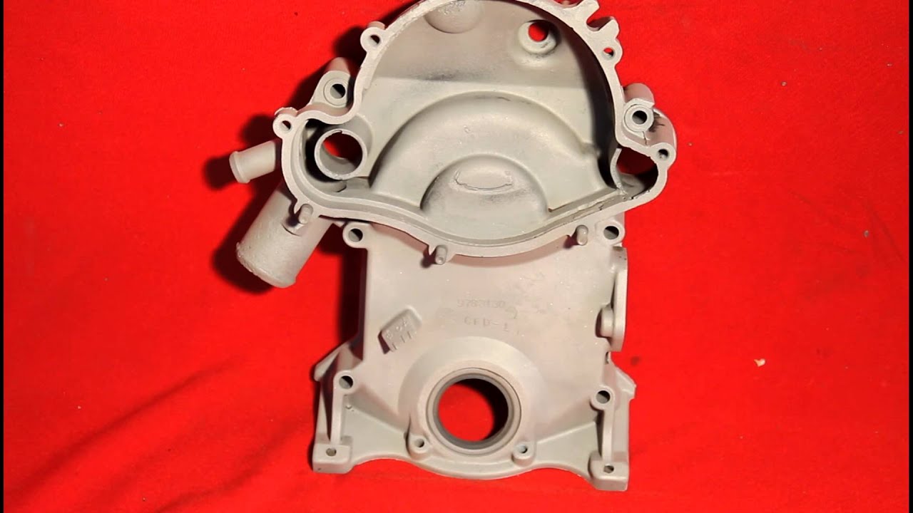

Old 08-09-2016, 02:48 PM
Gastiresandoil's Avatar
Join Date: Aug 2013
Location: West Coast
Posts: 124
I know this is either a 66 or 67 cover, but the studs are in the same place for a 68 cover as well.
