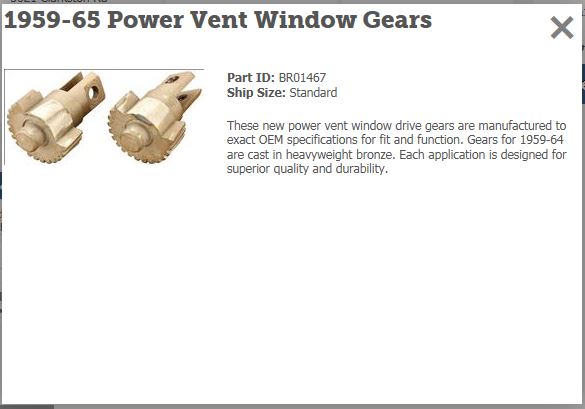

Found these at OPGI, and they are on their way.
I'll see if I can get the motor fixed locally.
K

By way of update:
New gears are now installed and vent windows working.
Left door: all switches working and the door is buttoned up for good. Had to run an additional wire through the door, under the IP and into the passenger door in order to get "vent window open" working.
Right door: switches were flipped for correct orientation and reinstalled. Everything works except passenger side window "down". Wiring is ok, and switch checks ok, but the interface between the wiring and switch is (apparently) not ok. New connector on order from our host and I'll finish it up when the parts arrive.
