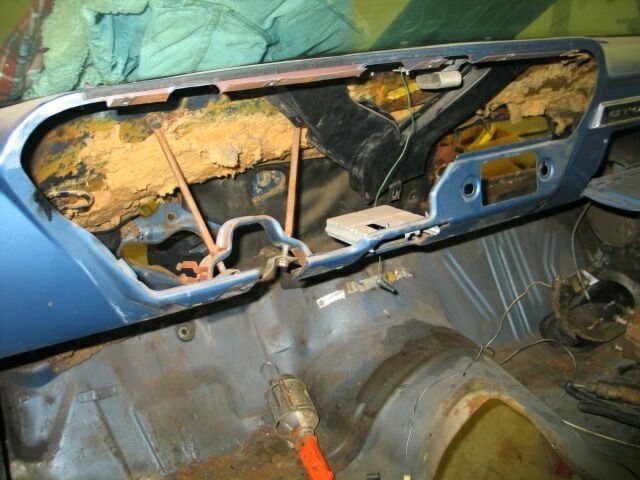

7. Factory Install sheet shown for wire route.
8. It looks better so you don't see the wires.
