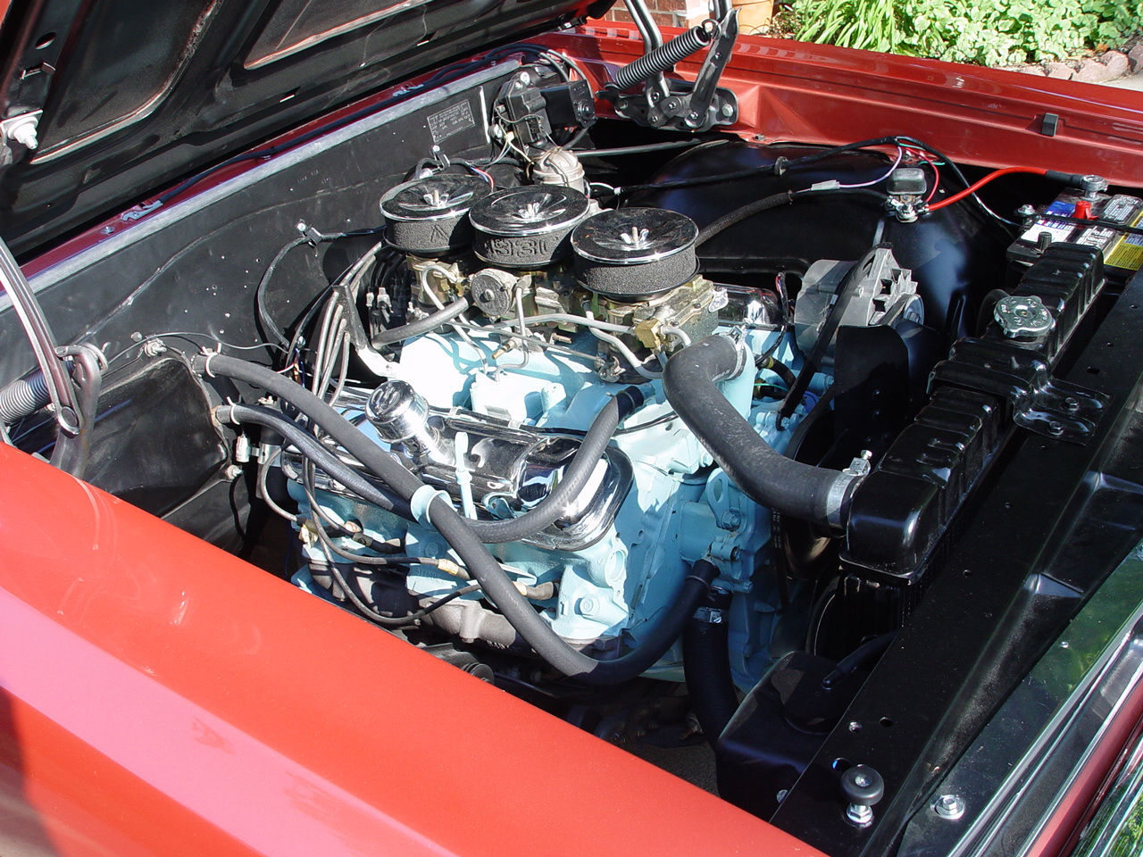

Here are 3 pictures from my collection:
First picture clearly shows the two sides of the heater bracket "loop" being parallel with each other.
The bracket really never traps completely the lower hose. The "kick-out" allows "rolling the lower hose into the bracket.
Upper hose being the one to the cross-over naturally.
Second picture shows even better how the rwo sides are parallel looking across the engine, no twist.
Third Picture shows the Radius in the edges and the valley that helps the bracket from cutting the heater hoses.
You can see the slightly higher edges of the bracket in your first picture, John.
I think you just need a bit of heating and rebending to get it back in shape again.
Tom V.

Do not remember the lower arch at all on my bracket, straight like John's just not twisted.
Tom V.
