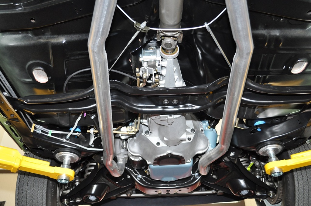

This car, looks like everything up front is the same "cast" type gray.
A little hard to tell though. the bar looks brighter than the steering pitman arm where your can just barely see it.
