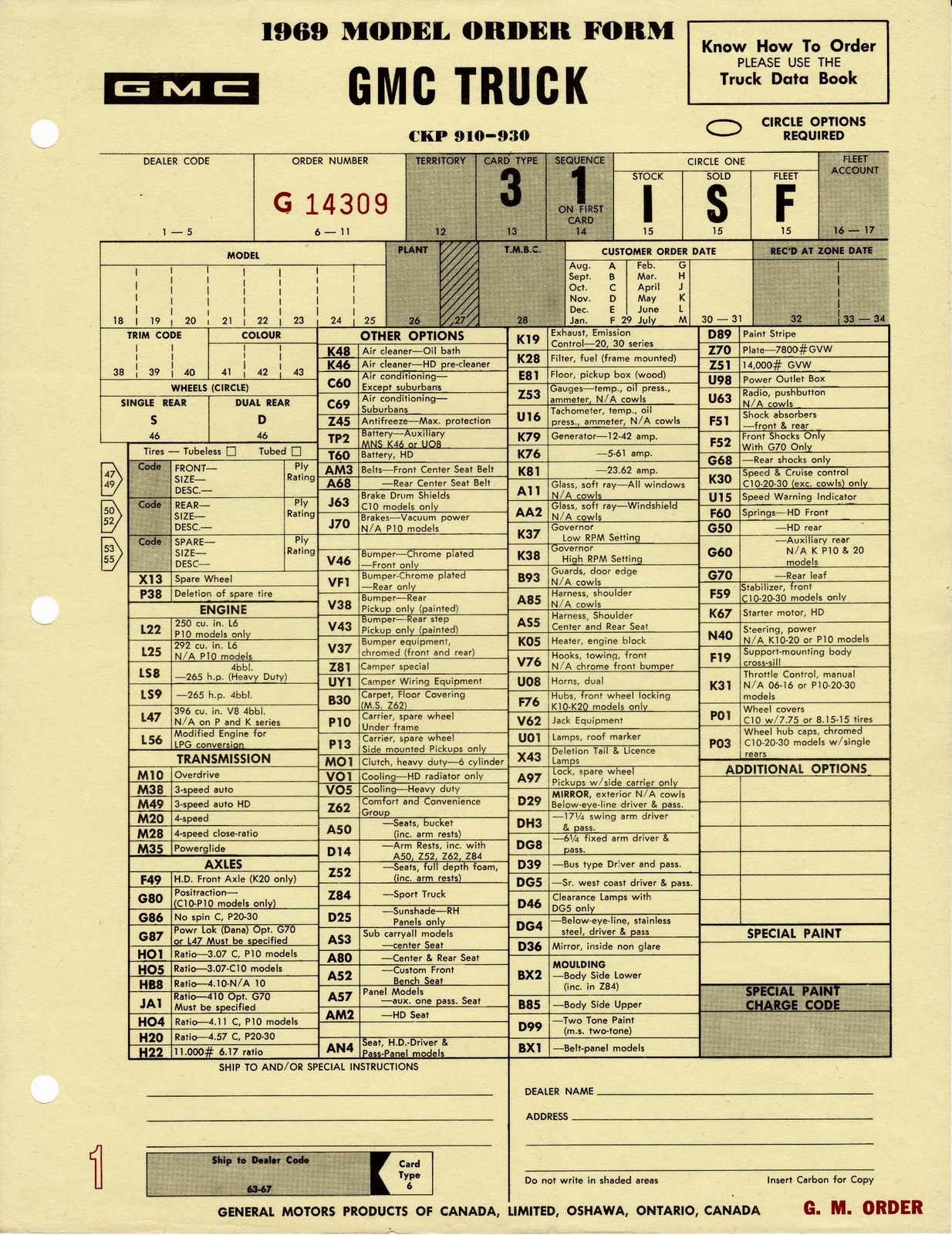

Originally Posted by 78 WS6 View Post
I'll assume you are too young to get the point. In 69 GMC was in its V6 era 305 & 351 cu. in. In earlier days when GMC had V8s they were not Chevy but Pontiac. So the point here is a "what if" 69 GMCs still had V8s and were still Pontiac. All the Chevy/GMC twins came later.
That info doesn't jive with the 1969 GMC Order Form:
Looks like either a 250 or 292 ci inline 6 or an assortment of L code V8's (LS8, LS9, L47 and L56).
My dad sold GMC's from 1963 until 1995.

... I was guessing that '78_WS6' made a typo;
I believe that from at least 1967 GMC trucks used chevy drivetrains;
My cousin owned a 1969 GMC with a 396 - and I have understood that the same generation of GM trucks all used the same drivetrain.
Did your Dad sell GMC's in Canada ?
Thats a GM of Canada order form
Just wondering because most all GM/GMC products built in Canada prior to 1970 had Chevy drivetrains.
