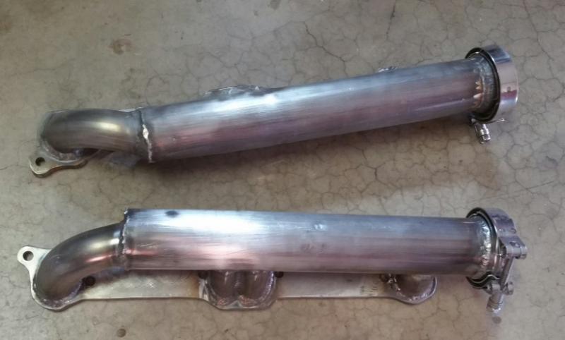

High 4's with an uncut wheel well means small tire. If you can run a high 4 on the street with a small tire, you will be the king of the small tire in this country.
Last month at a small tire airport race, there was a 200,000.00+ car there with traction control all the bells and whistles, high 5 at best with small tire on the street.
Anyway, headers are a pita for Pontiac, If I was to do it over, I would built a log manifold. Good luck on the build keep us posted
Old 07-18-2019, 08:01 PM
68azbird 68azbird is offline
Join Date: Mar 2014
Location: AZ
Posts: 739
Yea Logs
It is easier to fool a man than it is to convince he has been fooled

Originally Posted by gata79 View Post
Well, forging ahead I’ve ordered a 4 inch stroke scat crank from Butler. I’m going to order pistons Monday. I called a couple of guys about headers, but haven’t heard back. I’m not sure about turbo sizing or brand. Again I’ve called people and left messages but haven’t heard back. This may be a difficult build, but it’s going to happen.
Your best bet will be to keep it simple. Short and sweet with the header. If you have the ability make your own. Keep the primarys between 1 3/4" to 1 7/8" and the collector needs no more then to be 2 1/2" . Anything more is just for show and will slow down spool..
If you can aford it. This turbo would be good for what you want to do when set up as twins IMO....
https://www.precisionturbo.net/Stree...PT6875-CEA/661
Good luck . Should be a fast car when all said and done.....
My Half AN Injun.....
