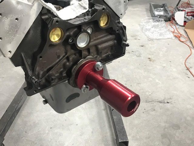

If you have never tried the Browell tool, it is a life changing event.
Stick this part on the crank.
My bellhousing was about .014 off in one direction, so a pair of Lakewood offset dowels got her dialed in.
This tool was about 150 bucks and well worth the cash. No more dicking around with a dial caliper, it is either go or no go.

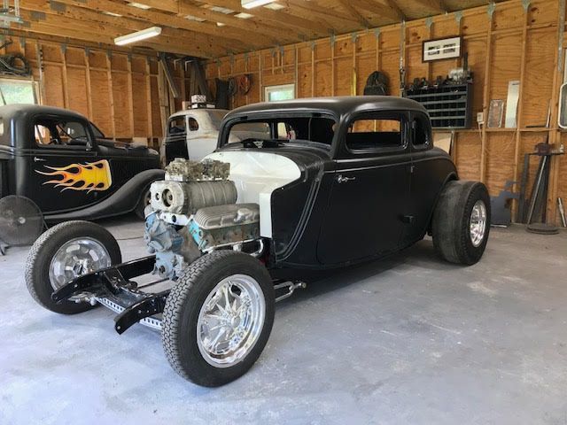

Here is the car with the engine mocked up. I don't post it much because it is a F**D, but she will have a nasty little blown Pontiac which makes up for it.
-Abone.

Thanks for the pics of the tool set-up on the engine. That's very slick. So I assume you dial the bellhousing around until the black ring slides smoothly through the register hole?

[QUOTE=mgarblik;6180134]Thanks for the pics of the tool set-up on the engine. That's very slick. So I assume you dial the bellhousing around until the black ring slides smoothly through the register hole?[/QUOTE
BELLHOUSING/TRANS REGISTER HOLE CENTERED ON THE TOOL "RING" (YOU CHECK THAT USING FEELER GAGES AT THE DIFFERENT POINTS AROUND THE RING).
I have used that tool, from the time they first offered it, on many different makes of vehicles.
We had to make a few custom sliding rings for the research engines.
Tom V.

What centers the tool on the crankshaft?
My Pontiac is a '57 GMC with its original 347" Pontiac V8 and dual-range Hydra-Matic.

There is a "register" on the end of the tool that is bolted to the crankshaft.
That locates it precisely with the centerline of the crankshaft.
The tool is then attached using two of the flywheel bolt holes in the crank and proper length fasteners.
A very good design for the tool.

The tool locates on the flywheel register and the two bolts snug it down.

Seems like the only weakness would be centering the tool. It needs to center tight on the crank recess or it could be off sideways, or even slightly cocked if there was any imperfection under it.
But yes, I really don't want to spend any more hours twisting the crank with the dial gauge on the flywheel over and over again. I'll buy one if I set up another bellhousing.

I spoke with one gentleman, years ago, who purchased a offshore crankshaft, where the crank was "On center" but the hole register was slightly too large. therefore there WAS some slight "slop" in the Browel set-up.
What we did with him was we had the end of the Browel tool that registers the tool reduced in diameter (he had access to a GOOD machine shop) and two "Donuts" with the different register diameters made.
One for the "screwed up crank" register and one with the correct Pontiac diameter register. A couple of hours on a proper lathe got him back in business again. He was on a time line to get the parts installed properly. From that point on he installed his special donut in the end of the crank before installing the Browel tool.
I may actually have my Browel Tool modified the same way as then I know I am truly on center with the tool.
So if you are a sharp guy you can basically fix any pontiac or aftermarket
crank issue as far as the Browel Tool register.
