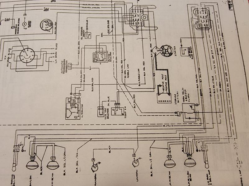

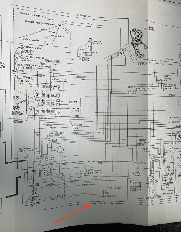

Well, I ran across another hurdle over the past couple days and am posting this as an FYI to the next guy that would decide to add these cornering lights to their GP J. I made an assumption (yes, I know the saying about assume) that the '69 and '70 Grand Prix SJ's used the same headlamp harness with the cornering lamp terminals on them. I bought a used harness from a '69 SJ to use on my '70 J and when I looked closer at the harness plug that goes into the bulkhead, I noticed that one of the terminals in the plug was missing from the location it was supposed to be according to my '70 Pontiac Service Manual. Terminals used for the cornering lamp option on the '70 are in location BS & DS. The plug on the '69 harness did not even have a tab at location BS. I found a 1969 Pontiac Service Manual pdf online and found that the cornering lamp terminals were in location CT & CU on the '69 harness. A quick continuity check confirmed this, so the '69 harness is a no go. All the other connections in the plug are in a different location too. The seller was nice enough to take it back and I can get a new harness from Ames or M&H, so it's just a bump in the road. But I just am posting this to possibly save someone else the grief if they do a search on this subject.

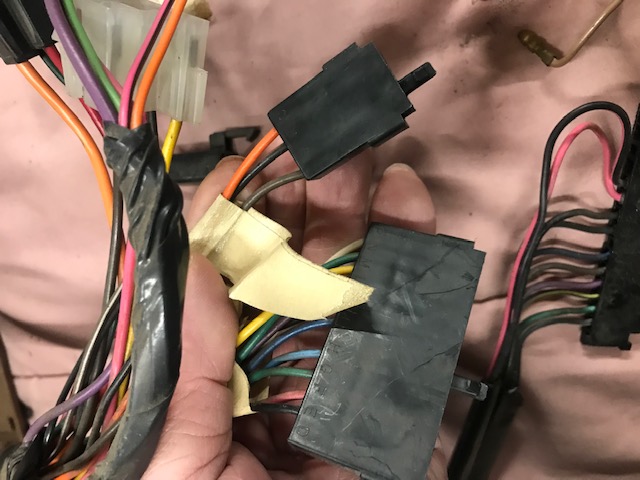

Old 04-09-2022, 12:09 AM
The dash harness was the same with and without the cornering light option but you do need the specific turn signal switch. However, I’ve seen many non cornering light cars where the extra connector for the turn signal switch has been chopped off by the factory during install. If you run into this you can always fab a connector yourself and splice it in to the harness.
Also, for the forward lamp harness you can keep your original and simply fab two new wires (lots of Packard connector kits on eBay). Just insert them into the harness bulkhead connector in the appropriate holes (as per the shop manual) by carefully removing the seam sealer in those holes.
Extra point to watch is to sand or grind bare the inner fender surface around the bezel mounting bolts as they require body grounding to function.

Old 04-10-2022, 11:29 PM
Good point about 70 vs 69. Easy enough to check though, two ways…
First have a look at the dash harness on your car and look for the second connector with three wires right next to the main connector above the column that plugs into the main connector on the lower side of the steering column.
Secondly, if you can’t access the car just look at a 70-71 vintage MPC (factory parts catalogue) and see if they list dash harnesses with or without cornering lamps.
