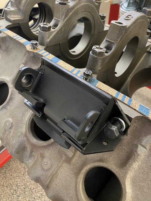

Dataway, thank you for bringing this to our attention! We have seen some of the nuts protrude too far into the frame bracket opening, some worse than others. The mounting holes to the block we have not seen until now. I grabbed a couple pairs off the shelf to try on one of our engine blocks here in the office. The holes left plenty of room for both bolts to be easily started. The fact that yours were so far off is very interesting; I'm hoping this is an isolated incident. Please feel free to email me at [email protected] with more pics and info. See the pics below:

Actually, to clarify ... the bolt hole spacing to the block is perfect ... it's their relation to the tabs that go over the frame mount that is the problem .... with one of mine anyway.
The holes on my right mount seemed to be shifted forward in relation to the tabs. Which meant I could either A: bolt it to the engine and it would not fit over the frame mount, or B: slip it on the frame mount and the holes would not line up with the block ( the condition when I took the photo). The engine was already installed and I lifted slightly, removed the Chinese mounts and replaced with yours.
Quite possibly a single problem with just one of my mounts. In the big picture ... these are so much nicer than the Chinese mounts that I'd still buy them if they all had the same problem :)
BTW ... the Chinese mounts have over size bolt holes, and the tabs are a much looser fit on the frame mount (due to the thinner metal) .. so of course they install easier, but work worse.
Just posting so you could keep it in mind in case it turns up again. I still have every confidence these mounts are FAR better than what was available in the parts stores and applaud you guys for bringing them to market.
We appreciate the feedback and clarification! We will most definitely keep that in mind for future reference if necessary. I'm glad you like the mounts! The replacement mounts that have been on the market for years were no longer acceptable. These along with our N242A "Torq Lok" mounts have finally filled that void. Thanks again Dataway, have a great day!
