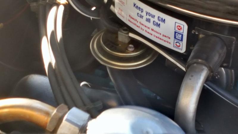

I have one of these and the line detached from the valve. It had what appeared to be JB weld on it but that didn’t hold. How do you repair these?

It’s better to block them off, who wants all that heat going up in the carb.
