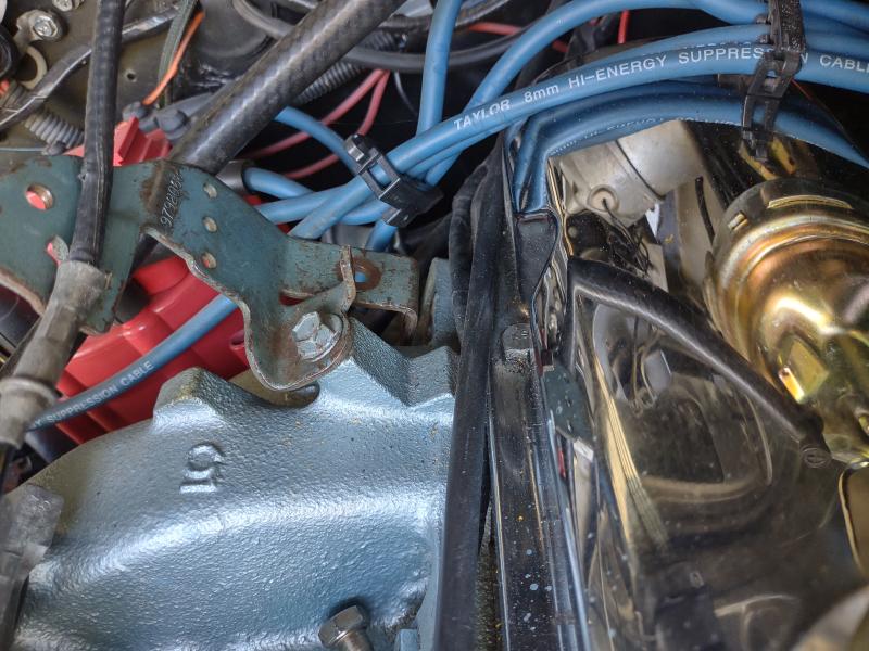

I've been fighting a slightly high idle for a long while. Can't get it below 900~1000 rpm. I finally figured out the problem isn't the carb but the throttle cable OR the bracket. The cable doesn't fully 'relax'. The reason the bracket looks so beat up is that I spent last half hour straightening it out thinking that was the problem. Now I suspect that someone bent it on purpose because it's even worse now.
Can someone post a pic from this angle, taken by zooming through the hood spring uprights. I don't think it's a factory bracket and I KNOW it's not a '68 bracket. No part number, it's just stamped 'TF' in a large font.
Sorry about the sideways pic. Something lost between my phone and laptop I guess. Basically, I want a sideview of the mounted bracket. Trying to see where it lines up on the intake.

IF that's a big - 2 after the T... then you have a 2bbl throttle bracket.
have never tried running the 4 bbl cable on a 2bbl bracket, have the correct 4bbl brackets.
Old 09-11-2022, 04:16 PM
You're absolutely right....it is T2 not TF. That may be exactly what the problem is. The fact that it has it's own identifier tells me that it's different. I need the cutout for the crimped end of the cable sleeve to move about 1/8th of an inch forward.
I have to mount it this way for it to idle down to the factory spec.
If I pull the flare back inside the notched out area, idle is about a grand in park.

Here's another difference that I forgot to mention. The lower mounting tab that goes to the manifold is suspended off the manifold about an eighth of an inch after I straightened it out. In the photos there is a washer underneath that lower mounting tab...so, I need a 4bbl throttle cable bracket.

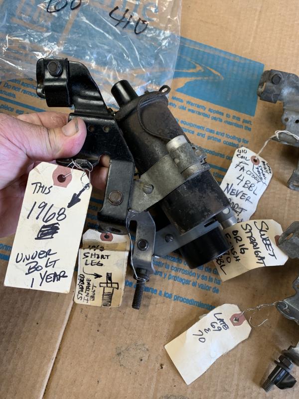

Here are a couple of pics of my 68. This bracket has a part number stamp. The bracket is original to the car.

Yeah, I found pics online with the part number and that's what made me think the T2 may not have been factory, until OPH explained what it is. The center pic you posted shows the difference. You see that the cable clamp on yours is roughly in line with the '5' on your intake. If you look at mine it is nearly an inch behind it. That's putting tension on the throttle arm.
Visually, they are the same but mounting the 2bbl bracket to the 4bbl intake doesn't work because the lower mounting tab doesn't reach all the way to the manifold surface and the cable-clamp portion does not reach forward quite enough to allow the throttle to completely close..

Ok, big surprise for me. The factory throttle bracket is pretty much the same physically as the T2 and obviously, has the same problem. In fact, when seeing it next to the bracket that was on my car I can see something that I had already suspected. On the T2, the rectangular hole that captures the 'lip' on the cable end has been enlarged to allow the cable to come forward, just not quite far enough....which is how all of this started. High idle.
So, mystery #1 can be seen in the photo. Why does the bracket not extend down to the bolt hole on the intake where it attaches to cylinder head?
It's like the boss on the intake is too tall.
With the bracket off, that boss measures exactly 1-1/8" from the top of the casting to the inside 90 degree below it.
Now that I have an original, I can see how extensively someone modified things to 'make it work'. I can't believe that I'm just noticing this. Even the clamp has been routed out to allow the cable to move more forward.

because thats probably a 69 up bracket that uses a bolt with threads on the top and a nut ,,,
68 went under the bolt head

'70-71 A-body bracket (except 71 RA 455HO) is stamped, A G P if memory serves right.
'68-69 the lower leg lays flush against the intake manifold flange.
'70-71 bracket, the lower leg sets up aprox a 1/4" & the lower leg sets on top of studded intake bolt.
'70-71 4bbl can be used on '68-69's but is cosmetically incorrect, must use studded intake bolt.
Have them all, as well as nice original cables.
No more '71 455 HO-RA cable brackets. always amused by requests for those... Pontiac just built a ton of 'em, LOL!

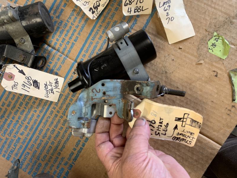

Here’s a 2bbl OVER a 4bbl

Ok, now that's just what l needed to see. Sending you a pm Scott.

Here’s leg length
long on top
You can use a 67
But
Originals don’t have coil bracket hole
I see u have hei.
I’m sure I have a 67 at the other garage in the 66-67 swap meet tub
I Thought I had a couple extra 68-9 4 barrel brackets Minus coils and brackets but I just have sets 67 is the same shape and looks the same just no hole for the coil bracket bolt under the head style the later ones are a little better with a stud I can mail you a bolt w stud if you need one
