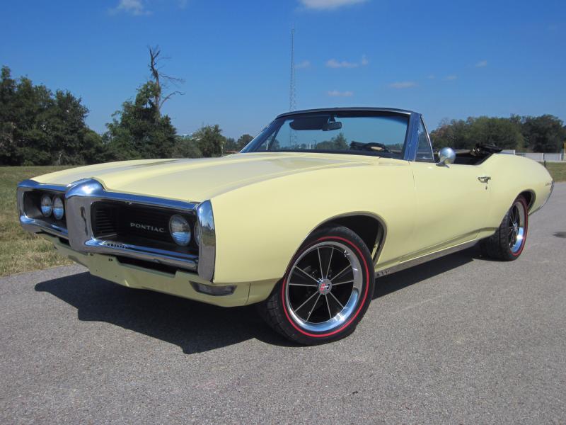

I believe it is width, not overall diameter. On my 68 LeMans Convertible I bought 17 x 8 Hurst wheels and put 275’s all the way around because that’s what I have on my 70 GTO with no issues.
Completely chewed up the newly redlined 275’s! I put 245’s on the front and have had no issues,
